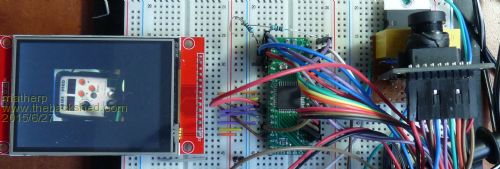

Only QQVGA (160x120) as that fills the Micromite memory. This version of the camera doesn't have a FIFO so the image is buffered in the Micromite memory and then written out to the display.
I need to tidy up the code and will post it as a follow up ASAP
I'm getting about 10fps running on a 44-pin part at 48MHz. The code won't run on a 28-pin processor as it needs a dedicated 8-bit port to transfer the image data in from the camera.

Here is the code and wiring details. Note that during each camera input routine (about 25msecs) the RTC has to be stopped to avoid missing data so the time will be incorrect unless a subsequent call to RTC GETTIME is used.
The camera has 200+ registers that can be set. The attached code sets up my camera to give a reasonable display but feel free to play with the initialisation, you could spend many happy? hours on this
There is one camera specific CFunction (44-pin part only) and three general purpose Cfunctions (can also be used on 28-pin parts)

The camera only works on the 44-pin part and uses the following fixed pinout:
3V3 - connect to +V : GND connect to GND
SIOC - connect to I2C Clock pin 44 : SIOD connect to I2CDATA pin 1
VSYNCH - connect to pin 19 : HREF connect to pin 4
PCLK - connect to pin 5 : XCLK connect to pin 42
D7 - connect to pin 3 : D6 - connect to pin 2
D5 - connect to pin 38 : D4 - connect to pin 37
D3 - connect to pin 36 : D2 - connect to pin 27
D1 - connect to pin 26 : D0 - connect to pin 25
RESET - connect to display reset : PWDN - connect to +V
