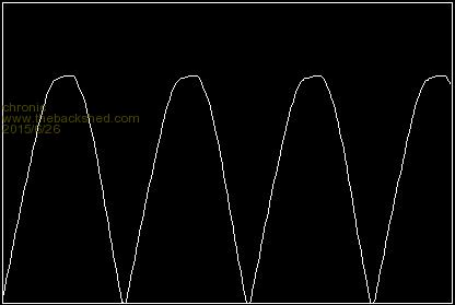

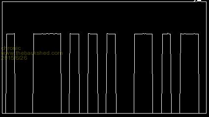

ripple from plugpak ,,
and a faster AD run , looking at 9600 rs232
The slow scan used this code or very similar, the TX routines are small and straightforward
