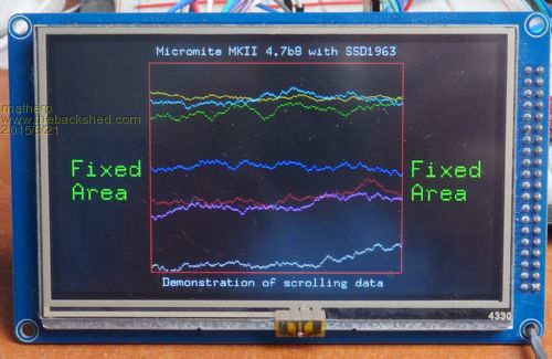

This has been on my to-do list for some time and I'm pretty pleased with the result
I've added a new function to the CFunction capability. This allows you to specify a region of the screen and scroll it right to left. There is no specific hardware support in the SSD controller for doing this so this is implemented by reading the pixel data from the display and then writing it back one pixel displaced. Despite this and despite only running a 9-bit parallel databus this takes only 50msec for the 280x232 pixel scroll area in the demo.
Please note to support this functionality the RD pin must be connected to the processor (you can select which pin), rather than being tied high.
At the moment the code only supports right to left scrolling i.e. new data is added to the right hand side of the area after it is moved one place left. This seems to me the most likely application but please let me know if there are specific applications that require an alternative and I can implement them.
Because this is all done in software you can of course have multiple separate scroll areas on the display.
Check out Youtube to see the code in action.
The basic code that created the demo is very simple:

The full program is attached:
2015-06-21_141412_scroll.zip
The program will only run on the 44-pin part as the performance penalty of not having all the data pins on a single port on the processor is too high. In the example each 50msec "scroll" represents moving 2.338 million bits (46Mbs)
The Cfunction also fixes a bug in line drawing so please cut and paste this version if you are using the previous 44-bit version

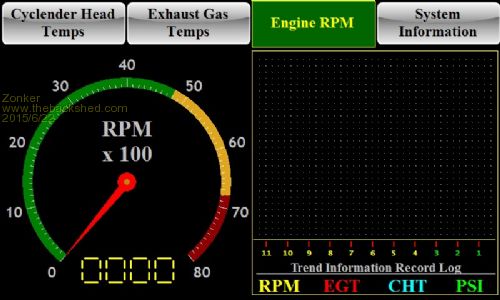

The 7" 4D systems display has a "trending" object also and I was using it to track RPM,CHT,EGT and OIL Pressure while staying on the "RPM" screen...
Still gathering parts to build up a demo circuit for the 7" display to test...
I am using a "powered" USB hub, so I am thinking to supply power to the display back-light from one USB feed and power the MM and display interface circuits from the other... (if possible)... If not, then I will need to provide a local supply to power up everything in one go...
