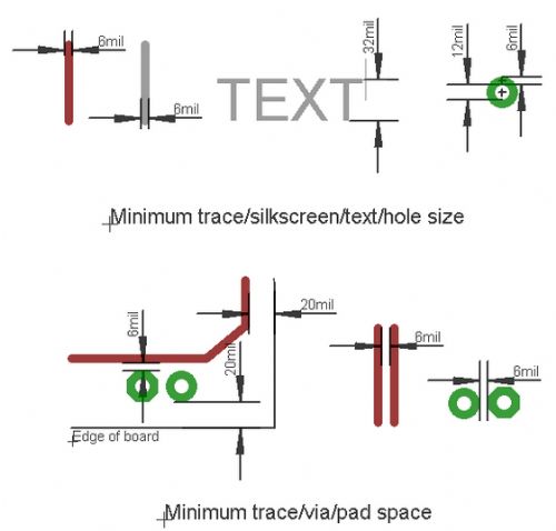

They claim to be able to manufacture down to 6mil (0.006") track thickness and spacing and I can confirm that I used 6mil tracks/spacing on my tiny (15mm x 15mm) NanoMite PCB, in fact the `shorting pads' are actually 4mil but they have etched perfectly with no sign at all of problems..
Here are their minimum widths and clearances

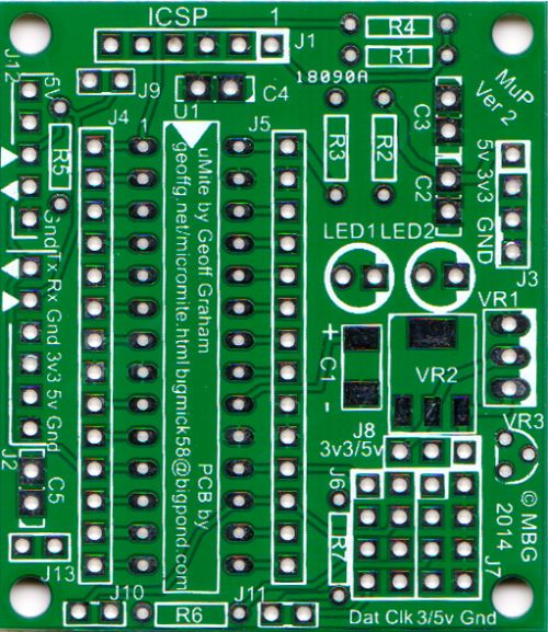

Here are a couple of more pictures of boards I have had produced by them.
MuP
RS485 Board I did for Work
So far I have had 10 orders and 13 runs of boards produced by them.. I have been happy with the quality of every single board I have had them produce..

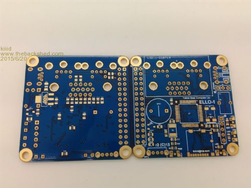

Posted: 07:19am 20 Jun 2015
Just had a look at them. 10 pieces of 4-layer 5x5cm ENIG boards with blue soldermask, just the specs of my ELLO-1 board which I am working on at the moment, come to $71.90.
Hardly the cheapest I must say. Noa Labs for comparison, which has been the factory of my own choice for a while, make very the same order for $54.40, and their quality is steady excellent. I can can recommend them to everyone for PCB or PCBA services.
Here is the exact board which is the word about.

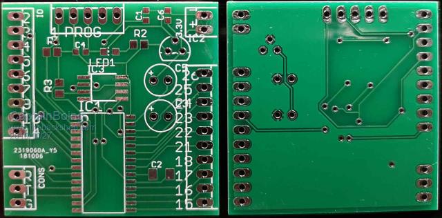

I always use JLCPCB. can't fault them. The latest board they just finished for me has yet to arrive - a weird shaped MM for a Harley Davidson. Got 10 of then for $2.00 + $7.53 shipping.
They have also produced my MM boards for general purpose micro-controllers, the quality has been consistently excellent. The latest (Mk5) arrived a couple of weeks ago x50 and I really have to save I can't fault them for quality, price and speed (which is more than can be said for my laying up capabilities).
I use these boards in a slide-in 3D printed frame or clip down case in reasonable quantities.
JLC and I have no affiliation so the above is my honest and personal opinionEdited by CaptainBoing 2018-10-28

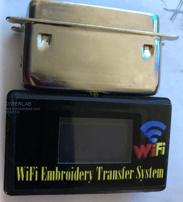

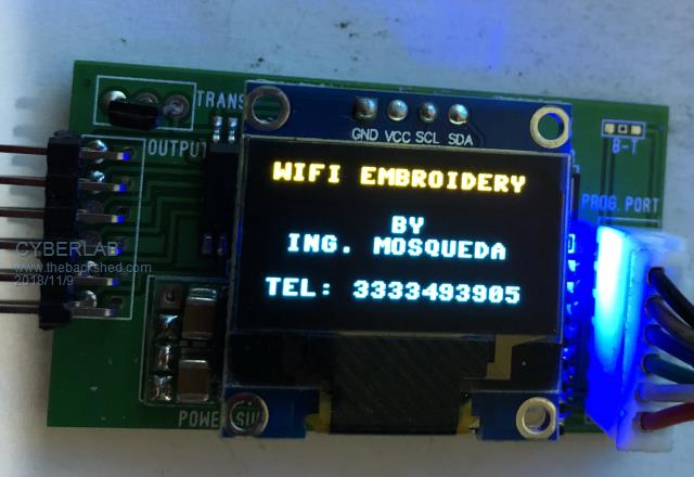

Posted: 02:51pm 08 Nov 2018
hello CaptainBoing, I want to thank you for the information about JLCPCB, I order 100 pcs of my printed circuit and they were less than 10 dollars plus 17 dollars of shipping, I sent my gerber files and exactly 7 days I have them in my hands assemble the first circuit and it worked perfectly, thanks again!
