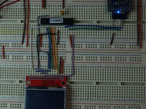

Not sure if I should start a new topic or use matherp's - MM2: 2.4" SPI Colour Touchscreen topic. Anyhow here it is as a new topic!
I have purchased 4 : TFT 2.4" Touchscreens from the link on matherp's topic.
I am having no luck in getting 2 of them to work (Not game to get the others out of their packaging).
They are breadboarded as the following image shows.
Can anyone see any problems? I have the jumper referred to closed and I measure 3.3v on pin 1 of the display. As this is the first time I have used SPI I have no idea what voltages I may be able to measure on other pins.
How do you best solve a problem like this?
I have successfully loaded all 3 of matherp's programs using MMedit into the uMite and can also edit etc from TT so I know it is not a uMite problem. uMite is running V4.6 .
Hoping someone can help.

I can't see your connection to the LED pin.
I think it's pin 23 on your breadboard and needs a ~18 ohm to 5V or 3.3V

  Quote  I can't see your connection to the LED pin.
Thanks Jim That did the job!! Knew it would be simple.
Fixed in less than half an hour Internet's great isn't it.
