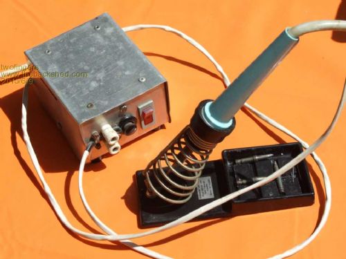

  robert.rozee said   i'm a great fan of the Weller WTCP irons.
I'm too!
  robert.rozee said   the base unit is just a 24v transformer, nothing more. so if you see a handle on its own going cheap, grab it.
This is a picture of my nearly 40 years (!) old Weller iron. I'm happy with it and I never had to replace anything.
BTW why use so many people a flux PEN? I use a small paintbrush and homemade flux (rosin in isopropanol).
