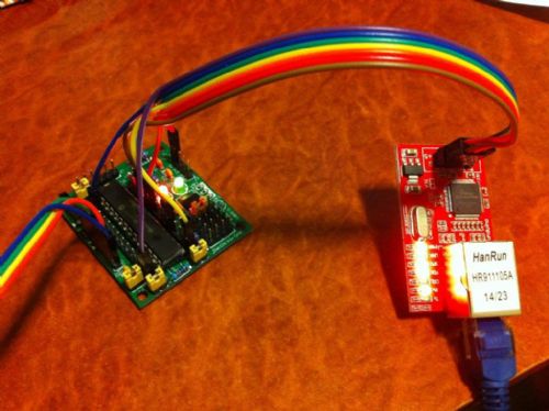

Howdy,
Here is the beginnings of a library for TCP/IP support on the Micromite using the Wiznet W5100 module - readily available cheaply on eBay, eg:
eBay listing for Wiznet W5100 module
This library of functions and subroutines has support for TCP server and client with an example of both. It could be used to run a small embedded webserver, or post measurements to a webserver periodically.
Receiving data from the Wiznet is a bit slow - byte by byte over SPI. It would ideally be rewritten in C if better performance were required. Although, I don't expect many embedded applications would require much in the way of data transfer - short messages periodically only.
The datasheet for the Wiznet W5100 module is available from here (there are later versions around if you search, but figured this should be a reliable link to publish):
W5100_Datasheet_v1_1_6.pdf
There is no DHCP support, only static IP address - the Wiznet W5100 doesn't support DHCP but you could add DHCP support to this library in MM-Basic.
Hope it's helpful to somebody.
David

I've written some brief documentation for the Micromite Wiznet W5100 Library, see below.
David

I found the Guidelines for Creating Libraries for MMBasic over here and have updated the Wiznet W5100 ethernet module MM-Basic library accordingly. I also fixed a few things, made some improvements and added UDP support.
2015-06-15_193612_micromite_wiznet_library_2015-06-16.pdf
Example Webserver:
