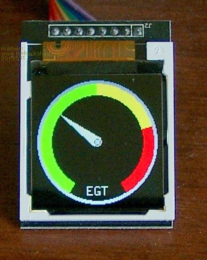

I'm playing with the development of some instruments for measuring things like Exhaust gas temperature (EGT), Cylinder head temperature, RPM etc. The display I'm using is the ILI9163 which is small (the unit must fit in a 2" circle) and bright. The code should run on an ILI9341 but I haven't tried it. However, as always, my coding is not complemented by my complete lack of artistic ability.
The display must be easily visible and the needle position must refresh without too much flicker. This is the best I have been able to come up with:
Comments, criticisms and alternative code greatly appreciated.

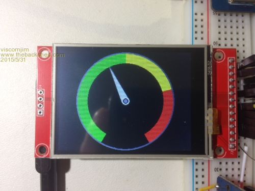

Hi Matherp, I tried your code but am running a ILI9341 display 2.4". This is what I got...
CPU exception #6 (bus error on ifetch) at address 0x383420
Processor restarted
Posted: 07:54am 31 May 2015
Are you running 4.7beta 8?
Video here Edited by matherp 2015-06-01
viscomjim
Joined: 08/01/2014
Posts: 925
Posted: 07:56am 31 May 2015
OOOOOOOOOPPPPPPPPSSSSSSS!!!!! My Bad. Running beta 3. Will update and tried again...
Loaded beta8 all is well. Here is a pic on the 2.4" display, the picture does not do it any justice. It looks really clean. You can't see the lines that are showing up in the picture. It just looks great!
Edited by viscomjim 2015-06-01

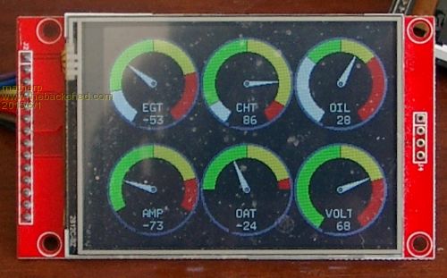

  Quote  Also in portrait mode I get the EGT but no numbers...
The version posted above was before viscomjim asked for numbers which I then added and posted the video. New code below.

Good idea I'll have a look at that
  Quote  Maybe add the "white" section on the bottom of the gauge scale.
This is easy for you to do or for any colour changes just modify the constants that define the segment start points and add another segment call to draw it.
  Quote  Actually it's not so much a flicker as sort of random, but seems to be the same each time it's run. At one point it travels about 30 deg. with half the needle white and half grey
This seems to be an artifact of the way the pixel updates take place relative to the raster refresh on the ILI9341. There is almost no effect on the ILI9163 and the ST7735 is about halfway between. I'm not sure if there is a way round this but remember at the moment the update rate is around 25 position changes/second. For a real EGT this would be 1/sec so the effect wouldn't really be visible.
Replacement main program code to display the text and numbers properly and scale the font depending on the screen size:
Option default none
Option explicit
CPU 48
Const stepsize=3
const displaystring="EGT"
dim integer lastx1, lastx2, lastx3, lasty1, lasty2, lasty3 ' Global variables to store last pointer position
Const greenstart=-150, yellowstart=0, redstart=75, blackstart = 150 ' position of display bands in degrees - must be in ascending order
Dim integer i, radius, firsttime=1, needlelength, fontmult
dim s$
If MM.HRes<=MM.VRes Then ' set the radius of the display less the "bezel"
radius=MM.HRes/2-4
Else
radius=MM.VRes/2-4
EndIf
if mm.hres>160 then
font 1,2
fontmult=2
else
font 1,1
fontmult=1
endif
needlelength= radius\5*4-1
Circle MM.HRes\2,MM.VRes\2,radius+3,0,,RGB(210,210,210),RGB(210,210,210) 'background to creat the bezel
segment(MM.HRes\2,MM.VRes\2,radius,greenstart,yellowstart, RGB(green))
segment(MM.HRes\2,MM.VRes\2,radius,yellowstart,redstart, RGB(yellow))
segment(MM.HRes\2,MM.VRes\2,radius,redstart,blackstart, RGB(red))
segment(MM.HRes\2,MM.VRes\2,radius,blackstart,greenstart+360, 0)
Circle MM.HRes\2,MM.VRes\2,needlelength+1,0,,0,0
text mm.hres\2-len(displaystring)*4*fontmult,mm.vres-fontmult*33,displaystring ' string centred in black segment
do ' run the pointer backwards and forwards
For i=greenstart To blackstart-1
s$=str$(i,4)
needle(MM.HRes/2,MM.VRes/2,needlelength,i,RGB(white))
text mm.hres\2-len(s$)*4*fontmult-4*fontmult,mm.vres-fontmult*19,s$ ' string centred in black segment
pause 10
Next i
For i=blackstart-1 To greenstart Step -1
s$=str$(i,4)
pause 10
Next i
loop
End
paceman
Joined: 07/10/2011
Posts: 1329
Posted: 01:07am 01 Jun 2015
Interesting - this version is much better in relation to the 'flicker' artifact i.e. on the 2.8" ILI9341 screen. But as you say Peter, with a low refresh rate it shouldn't matter.
Greg
Posted: 03:27am 01 Jun 2015
Here is a new version better implemented that supports multiple gauges on the same display
All the colour segments, locations and sizes are now parameterised so it is much more flexible.
I've also re-written the triangle drawing routine to output multiple triangles in a single call to the Cfunction. This allows the blanking pointer and the re-draw to be done together as fast as possible. This has reduced the appearance of the artifact but it is still there. The ili9163 is much the best display for a single gauge but the bigger displays are more flexible as above.
Option default none

viscomjim
Joined: 08/01/2014
Posts: 925
Posted: 03:34am 01 Jun 2015
Matherp, I am very impressed!!!! This is GREAT!!!!! Thanks for all your hard work. Your efforts are making the uMite quite the controller for so many things, my head is spinning!!!! That goes for Geoff also of course!Edited by viscomjim 2015-06-02
Zonker
Joined: 18/08/2012
Posts: 772
Posted: 12:16pm 01 Jun 2015
OMG..! Awesome Peter
I just got home from work, and looking at the changes... I see white bars... Nice
Time for a little fun...!
EDIT: Wow... A lot of function packed into a tiny box of code..!!
Ok... I think I need to look into getting gauge setup settings in and out of flash, then create some kind of setup screen... (sweet)...
EDIT: Head Scratching going on... (thinking about scales)...Edited by Zonker 2015-06-03
viscomjim
Joined: 08/01/2014
Posts: 925
Posted: 02:41pm 01 Jun 2015
Just had a chance to try this...
HELL YEAH!!!!!!!!
uMite just stepped up!!!!
Can't say thanks enough! I can't even image where this will go....
paceman
Joined: 07/10/2011
Posts: 1329
Posted: 02:58pm 01 Jun 2015
Wow, that's looking pretty amazing Peter - you, Geoff and Peter Carnegie should take a bow - and all on a $10 display with a $5 MX170 running the brilliant Micromite II MMBasic with CFunctions!
Greg
BTW, I can't see those artifacts at all with this version on the 2.8" using ILI9341 controller.
Posts: 2984
Posted: 07:03pm 01 Jun 2015
Brilliant Stuff,
Wow!!,
I have to go change my underwear, this is very exciting stuff.
I knew as soon as I saw Peter coming out with code for these displays that this was something special.. well YES!! It is very special. I have a display mounted in the front of my PC in the space where 2 x 3.5" floppy drives would go permanently running this demo..
Now to find a use for it on my PC desk..
I also confirm no grey artifacts seen but I do see the V and the T in Volt get over written if the value is too low or too high. But then this is a demo of course..
Edited by bigmik 2015-06-03
