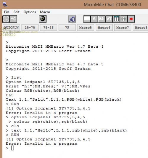

I have just installed 4.7 beta 3 ... the instruction " option lcdpanel " seems failing:
If I remove the instruction " option lcdpanel " it works!!
OA47

I forgot to indicate that I have a LCD ST7735 1.8" 128x160 from sainsmart...

@CFLY you cant use option lcdpanel within a program.
GM

Christophe
as the message is saying, it is invalid in a program. You can only issue that option from the command line. Not in a program.

OK thank you, thus, if I want to have an application which runs only, without connection with the pc, after transfer of the program, in command line :
" autorun option one " and " option lcdpanel " ... ok, good ...

"option autorun on" and " option lcdpanel..." ...

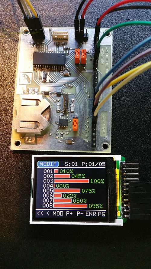

Posted: 05:02am 20 May 2015
An example of realization with the MkII 28b and MMbasic ver 4.7b3. And 1.8 TFT LCD ( ST7735)...
CLS, ROX, tested RBOX and TEXT ... it works well...
