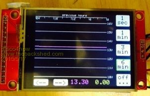

Back in December I stumbled across TBS and Micromite while googling. I had not played with electronics since the 80's so I ordered a couple of MUPs off Mick to see if they could be the solution to some problem I might be able to dream up. Well here it is!
We have a caravan and when we are free camping I am always looking at the battery voltage to see how the batteries are holding up. The car has a dual battery setup and a national Lunar dual battery monitor that shows a row of LEDs that represent the voltage of each battery. In both cases you see the current voltage, what would be more informative would be to see the history of the voltage as well.i.e. is is going down fast, holding. Enter the MMII Dual Battery Monitor using the ILI9341 touch screen to graph the voltage.

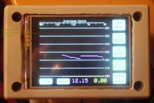

The screen has left and right next page buttons across the bottom and down the right a number of different mode buttons. The time scale is across the top. The area left (240 pixels by 180 pixels is used to display a rolling graph of the 4 values. This is updated each second with the existing values move left by one pixel and the new values added at the right most pixel. There are six pages stored.
In the 1 second mode the most recent 24 minutes worth of 1 second readings are available.
In the 1 minute mode the most recent 24 hours of 1 minute averages are available.
In the 3 minute mode the most recent 72 hours of 3 minute averages are available.
In the 6 minute mode the most recent 6 days of 6 minute averages are available.
All data is stored in the MX170 memory. When data is read it is converted to the y coordinate where it will be graphed. So actual values are not stored, just the y coordinate of where they would display. This means the range of values is 30 to 210 so 8 bits is enough. This allows 4 values to be stored per word so memory is conserved.

This shows a battery being discharged and then recharged over a number of hours.

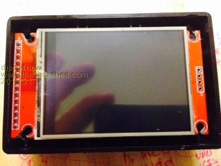

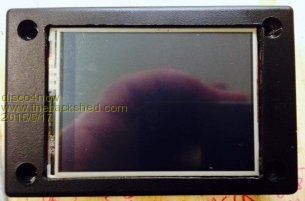

I have housed it in a Jaycar jiffy box but needs a few things adjusted.

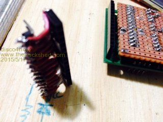

I built the first prototype using a MUP ,some veroboard and many soldered wires.
The next two are based on Micks BP170.Uses the same pins and drives the display on PWM via pin(26).
To get the screen to fit in the box I could not piggy back the BP170, so made a little connector to straddle the posts in the case.

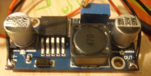

To get the 5V supply from 12 volts I have used one of these DC-DC converters.
DC-DC LM2596 Step Down Module Adjustable Converter Power Supply Output 1.3-35V
Got them from here.
It does not get hot like an LM7805 and is quite efficient.
The system draws 52mA @ 12.5V when on and 14mA @ 12.5V when the screen it off.

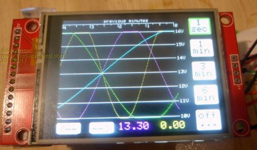

The software I will load here will display 4 scrolling sine waves and should work straight on a BP170 without any hardware other than the screen.
Swap the active declaration at line 39&40 and comment out lines 191-197 and it becomes the dual battery monitor software reading pins 23 and 24.
The dual Battery Monitor graphs only two values, but uses the other two graph values to make the line a bit wider and smooth the graph. So each graph is the value and the value +1 or -1 to make it two pixel deep and smooth it.

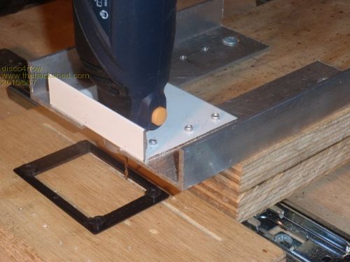

Here is my jig to try an improve the screen cutouts. A couple of draw runners to try and help with a straight line.
This one is a bit better.
I also need to elongate the mounting holes in the screen a bit.

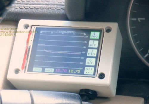

Its working in the car without any issues so far. (Diesel)
This is what the sine wave example looks like.

I hope someone comes up with a great little enclosure for the BP170 and screen as I am not really happy with my cutting out.

I soldered the BP170 directly to the screen so it cuts down the height.. Of course BP170 has its own uMite chip so you could probably do away with the MuP if there is enough IO left for you..

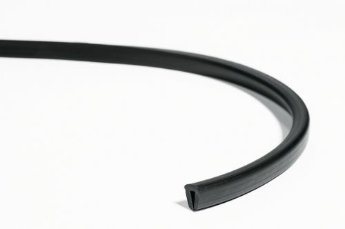

As to the cutouts... Yes a bit rough but if you can source some of the U-Shape cable protection tube similar to this one....
You can make a nice facia around your cutout and no-one will see it being rough..
You can even bevel 45 degrees and make it fit perfectly.

Thanks for the idea on the U shaped stuff.There is also some T shaped stuff used when putting cupboards into caravans that has a long edge and a little cap that may work, else some silicon.

Gerry, I found some "T" section plastic strips at the local hobby shop. These strips come in white but can be easily sprayed black. I have made a frame around the display and it hides any rough edges made when cutting out.
Thanks Graeme,
I have ordered some, got some 2.4mm wide as well in case my cutting does not improve down to 1.2mmEdited by disco4now 2015-05-20

disco4now, I think the ones I purchased are 4mm and 6mm which cover the LCD border nicely.
