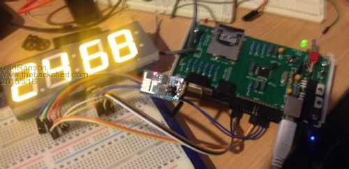

finally got my maximite driving a esp8266 module to act as a tcpip server and drive an i2c based display as well.
I can now send a tcpip packet with the digits to display.
once I've got the code a little bit tidier I'll transfer it to a micromite and make a much more compact unit.
eventually I have a big matrix display to get working for tweets and the like

Hi Carl, nice job there! Is the display the I2C one from adafruit? Would love to see your code for the esp8266. Are you finding that it is stable and do you know what firmware version it is running (the firmware on the esp8266)?

Yes, it's the adafruit display. I've also got the red,green,orange 8x8 display working. It uses the same driver chip.
As for the ESP, I had to go to the 3rd party firmware which allows the baud rate to be changed as the maximite can't do the higher speeds.
I'll post the code later on when I'm at my main pc
