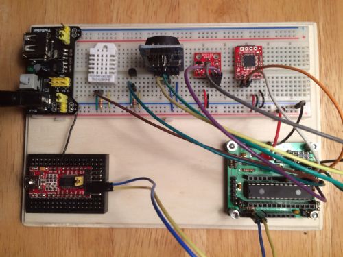

The following is a picture of the data logger. The 3.3 volt power supply, sensors and OpenLog are located on the large breadboard. From left to right; the DHT22, the DS18B0, the RTC, the BMP180 and the OpenLog device.
A USB-to-TTL interface is located on the bottom left and Big Mick's MuP board is on the bottom right.

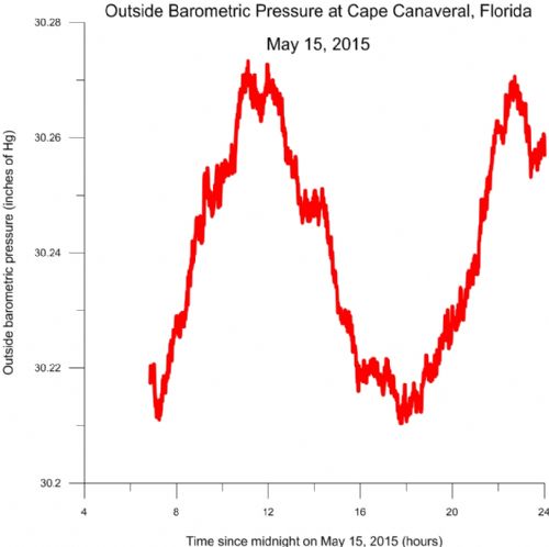

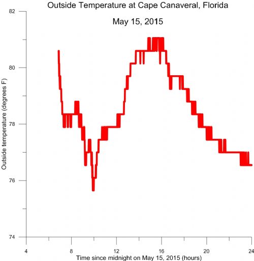

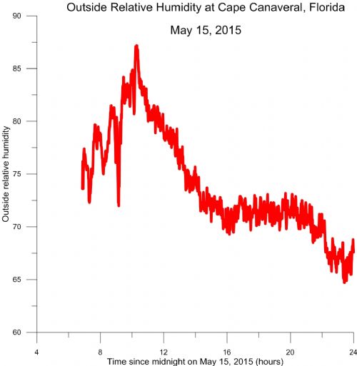

Here are several plots created using data from the data logger. They illustrate outdoor atmospheric conditions yesterday, May 15, 2015, at Cape Canaveral, Florida.
It was an overcast day with rain showers several times during the day.
