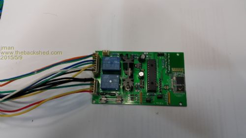

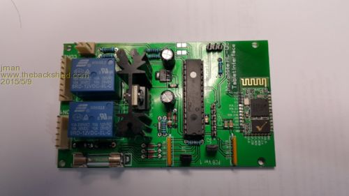

I thought I would share my latest project.
Micromite MKII HC05 Bluetooth Car Interface

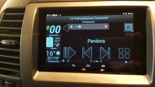

I have Nexus 7" Tablet in my car hence the project

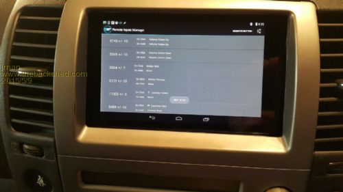

This device is a Bluetooth car interface for a Android Phone / Tablet
It sends a code via Bluetooth and this is used by an Android application to make the phone or tablet perform various functions
It has the following functions.
12v Relay output to Amplifier remote delayed to avoid thump on power up
12v Relay output for reverse camera

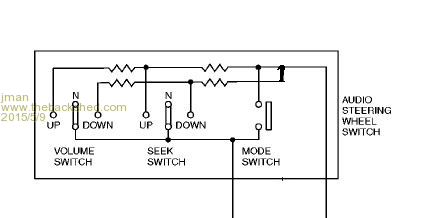

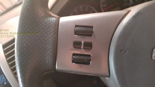

Analogue Steering wheel interface (Buttons press to code via A/D)
Reverse camera control via +12v trigger from reverse light
Rotary encoder for Volume control
Press Button (Incorporated into rotary encoder)
Short Press (Programmable in android Application)
Long Press (Programmable in android Application)
+8 second press will restart Bluetooth connection.
Input from Car Phone Kit This will mute the Amplifier and pause the current media
(My Car phone audio is routed to the front right speaker by the car kit)
1st Dash mounted press button
Press to turn on reverse camera (Even if car is not in reverse)
Press again to turn off reverse camera
2nd dash mounted press button
Press sends a code
Release sends a code
Each function sends a different number to the Android application
Steering Wheel Buttons (Depends on resistor values in car)
Phone triggered 10000
Phone call complete 10100
Reverse +12 input 11000
Reverse complete 11100
Dash Switch #1 1st press 12000
Dash Switch #1 2nd press 12100
Dash Switch #2 press 15000
Dash Switch #2 release 15100
Rotary Encoder right 14000
Rotary encoder left 14100
Rotary Encoder switch
Long Press < 1 second 13100
Short Press > 1 second 13000
Long + Press > 8 seconds reinitialise Bluetooth

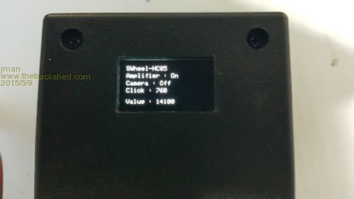

Then just because I had a .96" OLED display I added that so
you can see the codes sent when setting it up in the car
(Thanks to Peter for code)
The PCB was kindly designed by Grogster (Many Thanks G).
The code,PCB's and Android Application are available should anybody be interested.

SetPin 2, INTB, ReadAD
This will set pin 2 as an any change interrupt. (As you already know)
The source is the Steering Wheel buttons
So if a button on the steering wheel is pressed the SUB ReadAD is run
and then we use SetPin 2, ADIN to set the pin to read the analogue value once we have read the analogue value we run SetPin 2,INTB, ReadAD again.
The steering wheel buttons have quite low value resistors going to ground hence the
ADVal * 100 we now have a value for each button.

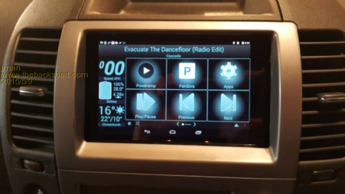

The car originally had a 6 CD in Dash Player. I removed it and installed the Nexus in it's place. (Thank goodness for my 3D printer). The Umite sends the data TO the tablet and the Android app process's it and preforms the relevant command.
The only mod I did to the Steering Wheel controls was to add a series resistor.
@ Viscomjim
  viscomjim said   Thanks again for the reply! One more question (hopefully). I come to understand that using a ucontroller in a automotive environment has its challenges as to the power supply. Have you found anything unusual about making things work in a car? Did you have to do anything different with the power supply circuit you are using?
The PCB as a ground Plane pour. The PSU is just a LM7805 and LM1117-N for the 3.3V. The board has lot of decoupling caps and the regulators have the required caps. Polarity protection is provided by a 1N4007 in series with the 12v input
Hope that helps

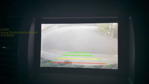

Posted: 04:02pm 09 May 2015
@ Gerry
This is done using a USB video grabber the Android Kernel I am using has the driver included.
The USB grabber was sourced from here USB Video Grabber
And lastly I use an Application called EsayCap that can be obtained from the Play Store here EasyCap
Hope that helps
