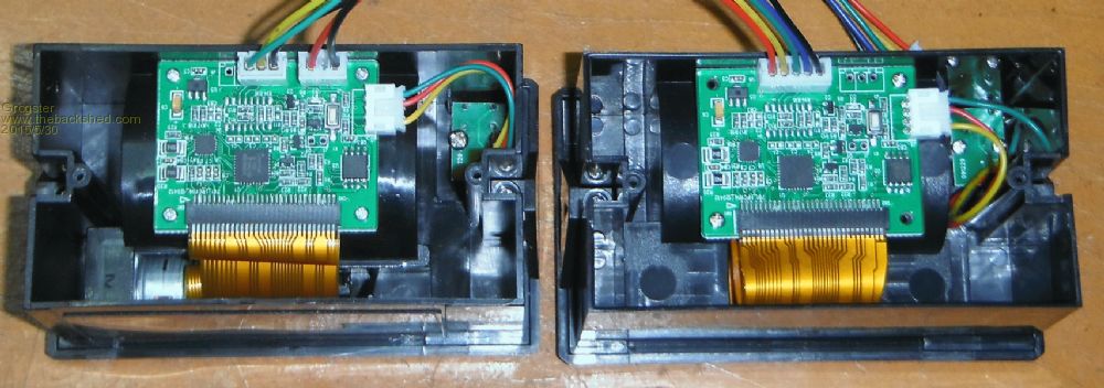

These printers cost about US$30 or so from eBay and the like - easy to drive, and produce surprisingly good results:
Simple testing code:

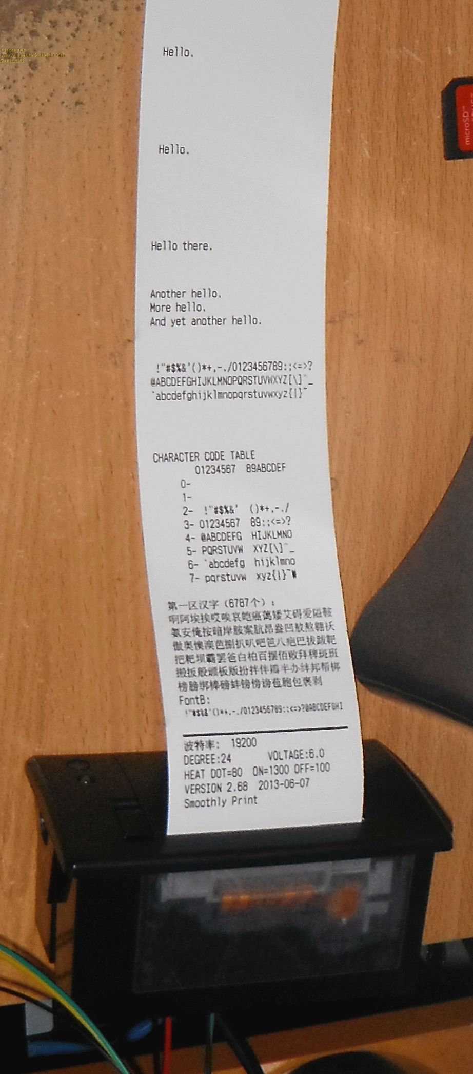

Another point I forgot to ask - can you possibly print a line of 80 characters (and just a few lines to see the 'line spacing').
By the way - I didn't know you spoke Chinese (looking closely at you sample print above!)

As to the Chinese, that happened when I sent it some wrong commands by mistake - it must have interpreted them as Chinese characters or something....

Posts: 10109
Posted: 10:52pm 07 May 2015
Here is a shot of the character set, along with a self-test print at the bottom.
You can have 32 characters per line in normal font.

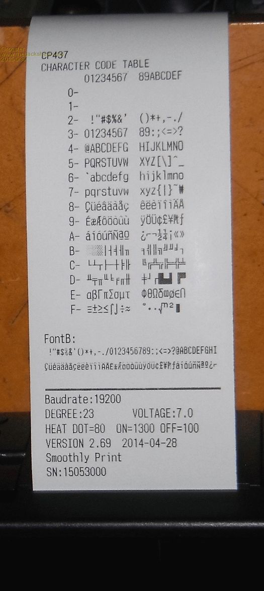

I see under your Chinese message to me that FontB is 41 characters per line (if my eyes are correct) and a leading space (or two). Is there another font offering 80(ish) characters per line?
This is just about readable in the photo but what is it like to read when it is front of your eyes (i.e. physically in your hands)?

Printout is extremely nice - very easy to read, not fuzzy or anything - just like any receipt you get at a shop. I have not played with the mini font yet, but that is next - you are right - that one gives more characters per line.
Character bytes 128-255 in the ASCII table are not the extended ASCII characters you might expect, but rather Chinese characters. The manual does go into how to re-define the characters, so one of the things I was looking at, was redefining some of those characters to the likes of extended ASCII for the single and double-line boxes(179-218). Not sure about this - depends on how easy or not it is to do, and how long it would take to send that data to the printer when you initialize it.

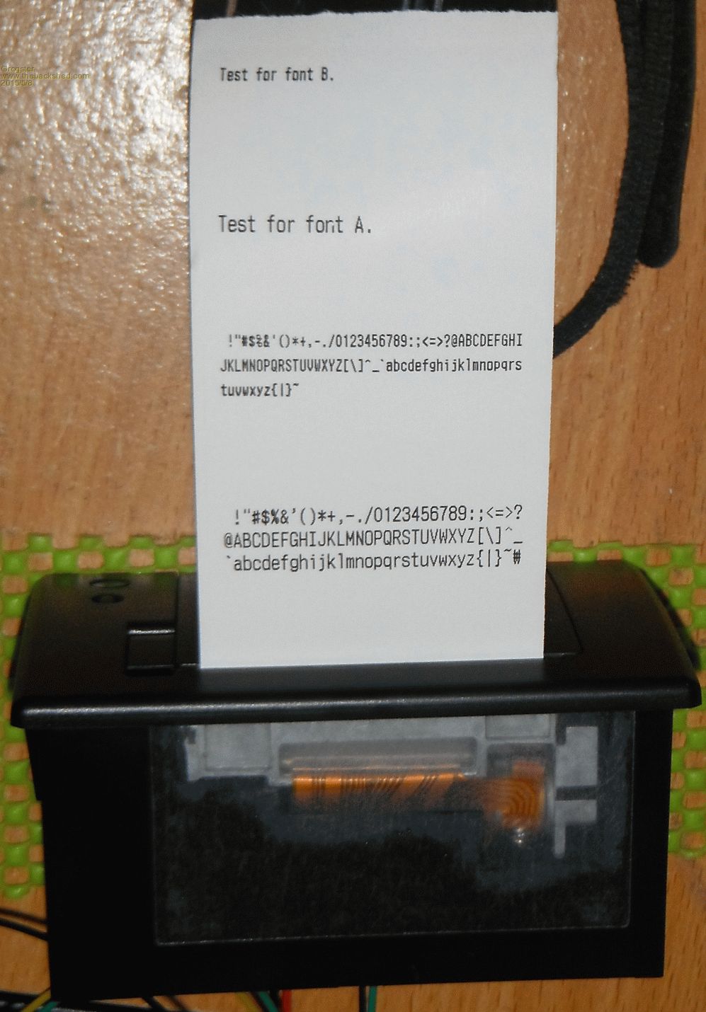

Have not been able to select FontB no matter what I do - The manual is not that great, being written in Engrish.
I will make the video now, and play some more with this idea later.
Posts: 10109
Posted: 01:19am 08 May 2015
I have found a better technical manual for this printer here.

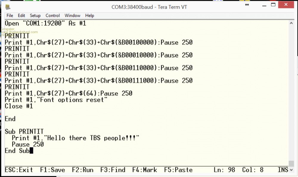

Selecting Font B(the smaller one) is done by setting bit0 in the data byte of the ESC+33 command. Therefore, ? #1,CHR$(27)+CHR$(33)+CHR$(&B00000001) selects the smaller FontB. Clearing bit0 restores FontA(the default size).

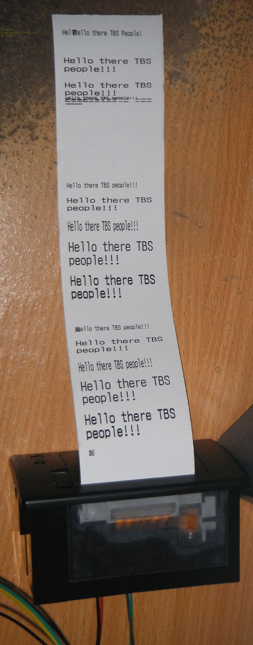

However, good progress:
Print time for each full message is about one second, and it shows up well despite the relatively narrow paper size of 58mm. More tinkering tomorrow, but for now, my brain wants the company of a pillow.
