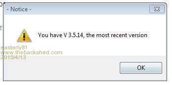

  easterly81 said
Im up to date.
That is not a message from a Micromite. You need to consider where you were and what command you made when you got that message. It may be from MMEdit or ....

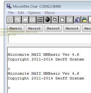

easterly81
Joined: 08/04/2015
Posts: 15
Posted: 07:33pm 12 Apr 2015
Im sorry u guys meant firmware? I am running 4.6 so i guess it was to to buy a pickit3 anyways.

easterly81
Joined: 08/04/2015
Posts: 15
Posted: 04:49am 14 Apr 2015
Well I borrowed a pickit3 and updated to 4.6b and all works. You guys are geniuses.
