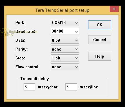

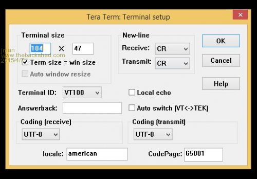

Hi
Yip settings are as below
Jman

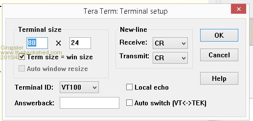

Posts: 10048
Posted: 11:06pm 06 Apr 2015
I don't have the coding boxes on my TT - what version are you using?

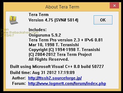

jman
Joined: 12/06/2011
Posts: 711
Posted: 11:30pm 06 Apr 2015
Jman

jman,
MMB 4.5 manual states tx delay of 50mS - that might help.
Also, don't quite understand the screen dimensions show? Again, from the manual, use 80 x 36 (assuming MM, miniMM or CMM).

BobD
Joined: 07/12/2011
Posts: 935
Posted: 11:42pm 06 Apr 2015
I have v4.82 and it shows the same setup page as Jman. The latest is V4.86 from SEP 14.

  panky said   jman,
Cheers,
Doug.
Well Bugger me
I set to 50mS and it is really BAD now set it to 2mS and it seems all good :)
Thanks for the help
Jman
EDIT: Still not perfect but better @ 2msEdited by jman 2015-04-08

Posts: 3368
Posted: 04:18am 07 Apr 2015
The mSec/char entry in Tera Term should be zero. The reason is that MMBasic measures the delay between characters to determine if they are the result of an escape code or not. If the delay is too great MMBasic will decide that they are being typed by a human and treat them as normal text (which is what you are seeing on the screen in your examples).
This is mentioned somewhere in the manual... but so is a lot of other stuff therefore it is easy to miss a detail like this.
If you want to slow down the speed of transmission use the mSec/line entry in Tera Term.
I don't know if this is your issue but it is a good candidate.
P.S. It is nice to hear from someone who appreciates the built in editor. I like it too - but then I am biased (not to take away from MMEdit which is great).
