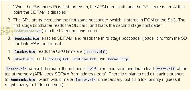

EDIT: I've done a little reading on the PI bootup thing, and found this on the net:

Well, its certainly a tangled web at boot time.
But this "binary blob" (bootcode.bin) is no secret. So perhaps it would not hinder someone porting the code?
