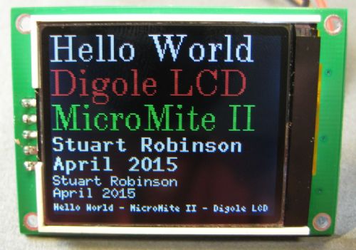

Here are some routines to drive the Digole Serial LCDs with a Micromite II.
This particular Digole LCD is 160x128 pixels, display area around 40mmx30mm, and it runs from 3V3.
Advantage of the displays is that they only need one I\O pin to drive them, so very easy to add to a project.
Now why cant you get something similar using one of those large and cheap TFT LCDs you see on eBay ?

Very nice.
I seem to recall matherp mentioning in one of his posts, that bigger LCD's are all parallel-port, and unlikely to be serial, SPI or I2C.
I think the reason is simply speed. Once you get up to the bigger screens, you have a lot more screen data to transfer, and this becomes inefficient when done using a standard serial-type method. It is inefficient because with the bigger screen requiring much more data for it's "Screen map" as it were, it would take too long to do it with serial, and it would result in visably sluggish screen update speeds, even with the serial running flat-out.
Smaller screen = smaller quantity of data that needs to be sent to the display.
I may have that wrong - this is just my interpretation of why the bigger screens all use a 16-bit parallel data bus.
Others here will correct me if I actually have that wrong.
