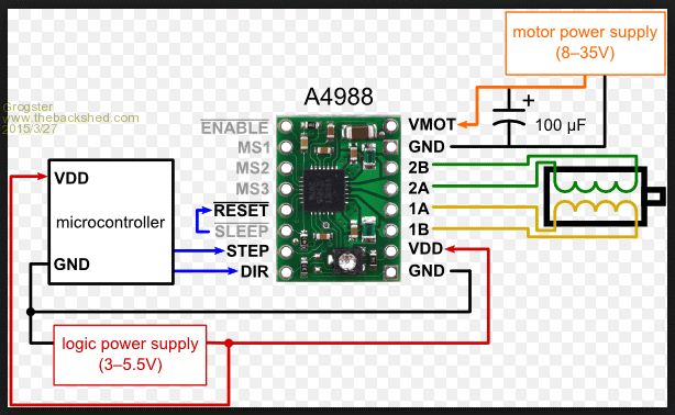

I need a slow RPM drive, which is variable from 0RPM up to about 30RPM max, so thought that one of these steppers would be a good starting point, but I don't know how to go about driving them. Is it as simple as pulsing each phase one after another at a variable frequency to alter the rotational speed?
EDIT: eBay sell these little driver boards which seem to be suitable, and you-tube videos show this controller being used, so I am looking at that module, connected to the 2-phase stepper motor, being fed from a MM output pin with PWM into the STEP pin.
EDIT: Yep, this would seem to be the best way to do it.
I think I have answered my own question - sorry.
I have also downloaded the datasheet for the 4988 chip.Edited by Grogster 2015-03-28
