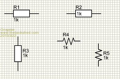

I use Sprint Plan for all my schematic work.
They support both the square resistors(which I personally prefer!), AND also the zig-zag type:

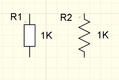

Hi Herry,
Of course AUTOTRAX DEX does just that
The little + signs next to the resistors signify pin 1 (I think) and can be removed if you do not wish them there..
AutoTrax DEX is totally free for non-commercial use (adds a non-commercial text to your GERBERs, I believe) and is fairly/very easy to use.

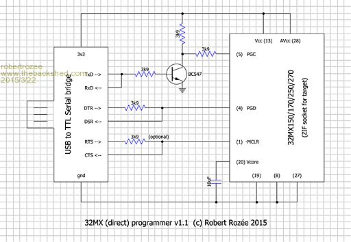

i use a program called DIY Layout Creator (DIYLC), a java application that is downloadable here:
https://code.google.com/p/diy-layout-creator/
it supports nice zig-zag resistors, though the transistors lack circles around the outside - but it is relatively easy to add the circles later on yourself. note that it is not a schematic layout program in the strictest sense, more of a drawing program that has been designed to aid drawing schematics. on the plus size, it is compact, simple, and it does also support creating veroboard layouts, which can be pretty handy.
completed work can be converted to PNG images or PDF documents. i use the PDF option, then convert into a GIF file for publishing using photoshop elements 2. with schematics i generally boost the gamma massively to achieve good readability when the resolution is reduced for display in a browser:

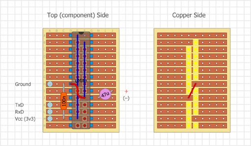

Many thanks chaps for all these suggestions. I will using my choice for Micromite Mk 2 projects on Veroboard. I've got Pebble for layout but it is easy drawing of schematics that really interests me. If they can be linked, so much the batter.
