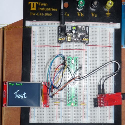

I've attached two copies of the full test program including the calibration routine. One is configured for the ARMmite driving a SSD1963 800x480 screen (default orientation landscape) and one for the 64-pin MX470 driving a 240x320 ILI9341 SPI screen (default orientation portrait) - see the picture above featuring the mighty Skinnymite!
Both are tested as working in all 4 orientations after initial calibration.
The code in both cases is identical other than pin definitions, SPI channel usage, and the binary code for the shellsort Cfunction.
