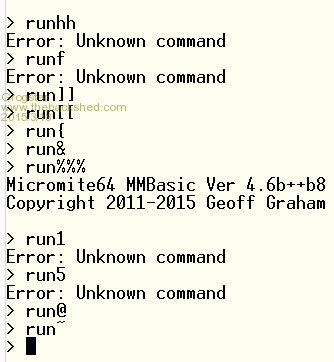

This is interesting.
Not fatal, just odd.
run command with symbols on the end does not result in an error, and code still runs.
All other typos cause an error as expected.

Good catch Grogs.
As you say, not fatal but hopefully Geoff will address.
Out of interest, which firmware & processor(s) are you seeing this on (just to possibly help Geoff eliminate)!

See the welcome message - 64 pinner, 4.6b++b8

Just tried it with Ver 4.5 and the same thing happens.
DOS version

You can probably find the same thing on other single commands if you try.
The biggest overhead in MMBasic is the interpreter i.e. reading each Basic statement. With a command like RUN, once the interpreter finds the valid sequence RUN followed by a non alphanumeric it is happy and executes as there are no valid parameters. Hence RUN5 isn't the same as RUN but RUN! is.
Not a bug - just a feature and probably common to every platform
