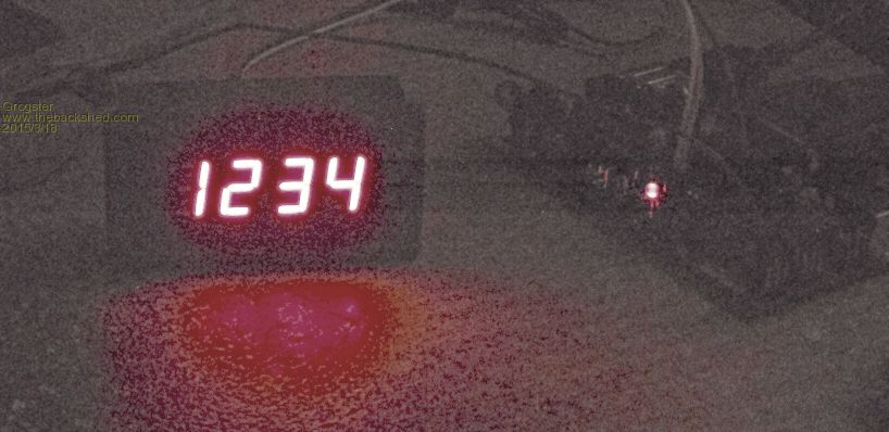

Posts: 10048
Posted: 01:39am 18 Mar 2015
PROGRESS!!!!!
Perserverence seems to be yeilding results.
Two mistakes I was making:
1) Forgot to connect the LED display GND to the Micromite GND, as I was using a different supply for the LED display due to it's current consumption
2) You need to leave the SPI port OPEN once you are finished. If you close the port, the display goes all "Flickery" - probably as SPI CLOSE returns the pins to a non-configured(read: high impedance) state.
Code that is working is:
SetPin 2,DOUT:Pin(2)=0
SPI OPEN 1000000,3,32
D=SPI(&B10000000100000001000000010000000)
Pulse 2,1 'Latch line
Do:Loop
This code lights all the decimal-point LED's.
Replacing with all zeros for the SPI command turns all the segments off.
This is how it should be.
Progress!
EDIT: Lots of progress.......
Enough for tonight.
1:17AM here - time to rest the little grey cells....
EDIT: You CAN close the SPI, but you have to latch the display first, THEN close the SPI port. Makes sense, when I think about it, but it is late, so my brain is on low RPM...
Nighty night. Edited by Grogster 2015-03-19

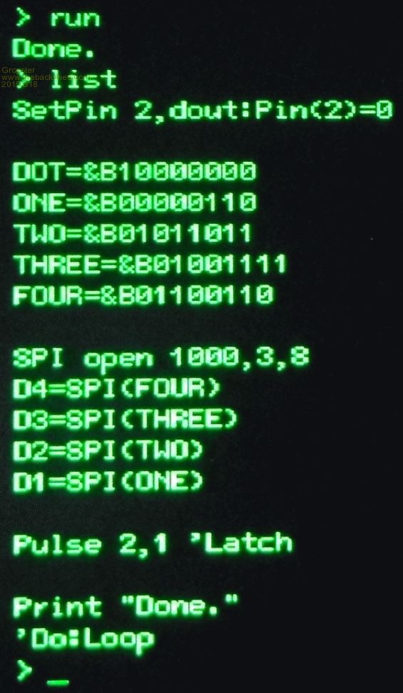

Posts: 10048
Posted: 10:06pm 18 Mar 2015
All up and running. Here is the sub that I wrote to take a standard textual input, convert that to numbers, and lookup a simple array to decode the bitmap for the segments etc.
SetPin 2,dout:Pin(2)=0 'Configure display latch pin
'SETUP SIMPLE ARRAY TO STORE DIGIT BITMAPS
Dim INTEGER DIGIT(10)
DIGIT(0)=&B00111111:DIGIT(1)=&B00000110:DIGIT(2)=&B01011011
DIGIT(3)=&B01001111:DIGIT(4)=&B01100110:DIGIT(5)=&B01101101
DIGIT(6)=&B01111101:DIGIT(7)=&B00000111:DIGIT(8)=&B01111111
DIGIT(9)=&B01101111
'MAIN CODE HERE...
'Demo code - can be removed.
Input "Number to display "; N$
Input "Decimal Position "; DP
LED (N$,DP)
Loop
End
'SUBROUTINE TO SHOW NUMBERS ON THE LED MODULE
Sub LED (N$,DP)
If Mid$(N$,1,1)="_" Then 'Detect blank request for this digit
D1=0
Else
D1=DIGIT(Val(Mid$(N$,1,1)))
EndIf
If Mid$(N$,2,1)="_" Then
D2=0
Else
D2=DIGIT(Val(Mid$(N$,2,1)))
EndIf
If Mid$(N$,3,1)="_" Then
D3=0
Else
D3=DIGIT(Val(Mid$(N$,3,1)))
EndIf
If Mid$(N$,4,1)="_" Then
D4=0
Else
D4=DIGIT(Val(Mid$(N$,4,1)))
EndIf
If DP=1 Then D1=D1+128 'Specify location of decimal point(0 for none)
If DP=2 Then D2=D2+128
If DP=3 Then D3=D3+128
If DP=4 Then D4=D4+128
SPI open 100000,3,8
D=SPI(D4)
D=SPI(D3)
D=SPI(D2)
D=SPI(D1)
Pulse 2,1 'Clock the latch to make the display visable
SPI CLOSE
End Sub
This is working very well.
You can send a _ character if you want a blank digit.
You specify the location of the decimal point with a number from 1 to 4.
