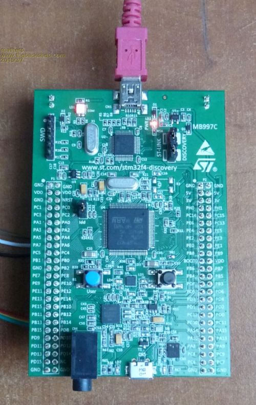

To get started with this the easiest way is to buy one of the STM32F4DISCOVERY boards. This contains all that is needed to program the firmware into the microcontroller and gives access to all of the I/O pins. Even better it is very cheap , typically around £12 in the UK.
It is important to get the STM32F407VG version of the board. This can be obtained from RS (part number 745-8434) or Farnell (Order Code: 2009276) amongst other places. Don't buy the STM32F429 version of the board even though it looks sexier - the firmware won't work.

To program the firmware into the chip you need to download and install the STM ST-LINK utility software
Then plug the Discovery board into a USB port on your PC, load up the firmware and program it into the chip. Leave the USB cable plugged in to provide power to the Board.
2015-03-07_155035_STM32B10.zip

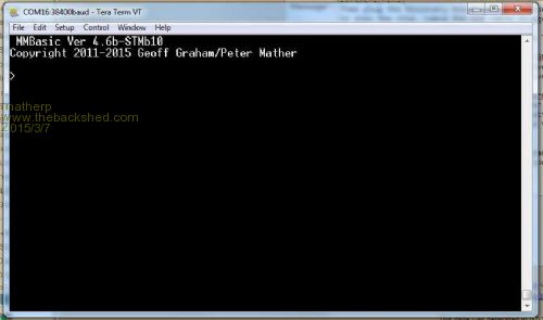

You then need to connect a standard USB to TTL converter to the console pins on the discovery board.
GND on the TTL adapter goes to any of the GND pins on the discovery board
RX on the adapter goes to PA2 on the discovery board
TX on the adapter goes to PA3 on the discovery board
Then open up a terminal on your PC (Teraterm or MMEdit) and connect to the appropriate serial port for the TTL adapter (38400 baud) - exactly the same as for a normal Micromite. Click the Reset button on the discovery board and you will get the ARMmite copyright message and the command prompt - you are then up and running.
I use MMEdit to develop and download programs - set MMEdit to Micromite MKII mode. Alternatively you can use the EDIT command from the console, exactly the same as the normal Micromite.
