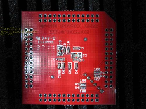

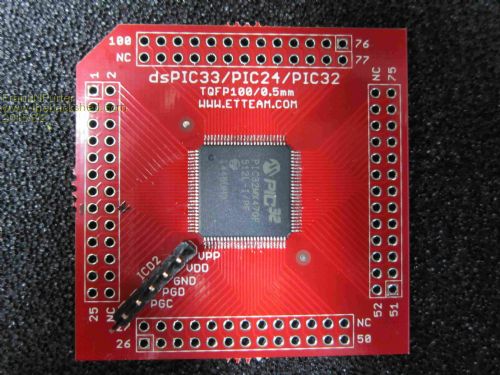

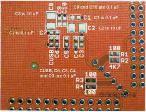

Posted: 10:37pm 01 Mar 2015
Hi,
here is my problem child!
I can't find any mistake - I didn't use the John's Raspberry software (not yet - no time )
I soldered 50R on R3 and R4 (PGC/PGD on 26 and 27). C8 is the VCAP and is the same capacitor as on my 32MX170 (which works with this PIC very well)
I measured a resistance between all pin's in megaohms!? All solder joints are looking good under my microscope...
Original AND clone PK3 doesn't find the chip...

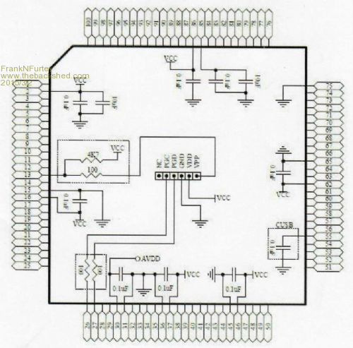

Posts: 12179
Posted: 10:50pm 01 Mar 2015
Compare the connections with the Colour Maximite circuit diagram.
I would expect pins 2, 16, 37, 46, 62, 86, AVDD (30) and VUSB (55) to all be connected to VDD. Pins 15,31 36, 45, 65, 75 all to GND.
The chip definitely won't run or program with AVDD unconnected (I've proved this!)
Edited by matherp 2015-03-03
Posts: 2998
Posted: 11:11pm 01 Mar 2015
Hi Frank,
I used one of these exact same BoB PCBs for my first homebrew MaxiMites. From memory, I had to make some (if not all) the power connections on the 'external' PCB that I plugged this module into. Looking at your photo's; how are you applying power to the MPU pins??
I now use different BoBs which have all the MPU's power pins connected to save having to do this 'externally'.
And as MatherP says, ensure AVDD is connected too as these are not connected to anything on the BoB.
Good luck . . . .
PS I'm sure you have checked already, but do check continuity between ICSP pins and their destination to ensure no breaks.
Posts: 2998
Posted: 11:19pm 01 Mar 2015
Hi again Frank,
Just dug out the MaxiMite on this particular BoB and done a quick continuity check. My memory failed me - this BoB does have the MPU's power pins connected to the ICSP but NOT the AVDD which as MatherP says, it must be connected too to Vdd.
Hopefully solves your issue . . .
Frank N. Furter
Joined: 28/05/2012
Posts: 1186
Posted: 01:23am 02 Mar 2015
Hi Phil, hi peter,
many thanks to your response!
I checked all connections:
2, 16, 37, 46, 62, 86 are all on Vcc
15,31 36, 45, 65, 75 are all to GND
I soldered a bridge from Vcc to AVDD (30) and VUSB (55):
"Unable to connect to the target device.
Failed to get Device ID"
Thanks again
Frank
Posts: 12179
Posted: 02:03am 02 Mar 2015
Frank
You have got R1 and R2 in place and the correct values?

Frank N. Furter
Joined: 28/05/2012
Posts: 1186
Posted: 03:30am 02 Mar 2015
Peter,
you are my hero!!!
What a stupid mistake! R1 was a 4k7 instead 100R!
Now I can flash the device without any error with power from my PicKit!
Many thanks to all for your help!!!
