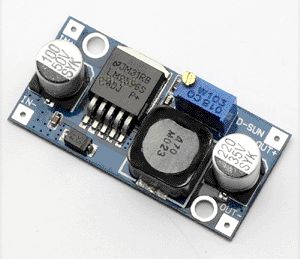

if the project has a similar power budget to the colour maximite, then i'd be inclined to suggest using an LM2596 buck-regulator to get you down to 5v. these can be purchased as a finished assembly complete with capacitors and magnetics for less than us$1 each on ebay (including delivery). see here:
http://www.ebay.com/itm/400595983355

the LM2596 is good for up to around 30v at the input terminal, and can deliver a couple of amps output. because it is a switching regulator, it will step this down to 5v with around 80% or so efficiency irrespective of the input voltage. hence, little heat dissipation.

I tested some of those ebay switchmodes and under no load, they draw about 11 mA from 12V.
I also prefer the switchmode to 5V followed by a linear 3.3V regulator.
