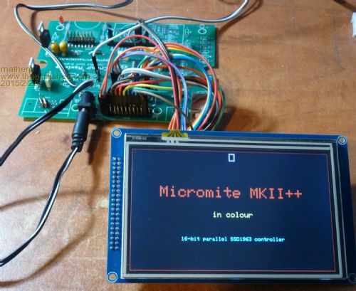

A 5" 800x480 TFT display using the SSD1963 controller arrived today.
I've built the code to run on the MX470 in 16-bit parallel mode. A version for the 44-pin MX170 would also work well although slower.
With the processor running at 96MHz the code can refresh the complete screen (800x480x16-bit pixels) in 25msec.
The zip contains the usual boring demo/test example code:
2015-02-20_192915_ssd1963.zip
The Cfunction source is:
2015-02-20_191926_SSD1963.zip
I haven't incorporated the touch screen code - this is just cut and paste from any of the previous examples.
At some future date I need to modify the Cfunctions to support the HK fonts but this is a big job. Although the SSD1963 is supposed to support hardware rotation I can only get inversion to work and not swapping row/column. This is supposed to work using bit 5 in register &H36 but this seems to be completely ignored.
The MX470 is running happily on a Colour Maximite PCB

  Quote  So, if you could show us a source for these 5" parallel touch screens, I would like to very much give it a go...!
This display is the one I bought. The code should also work on the 7" displays driven by the SSD1963.
I'm not very impressed with this display though. The colours are not very bright (compared to the 2.4" which is excellent) and the backlight takes over 0.5A.
Also the SSD1963 controller is poor. It doesn't support true hardware rotation and also address setting is only done in 8-bit parallel mode requiring extra instructions. Only the actual pixel output uses the 16-bit bus properly.
The trouble is these bigger displays start to get too expensive to buy just to play with.
This one looks really nice and has capacitive touch but is quite pricey. It would of course need the Cfunctions updated but is it worth the effort?
