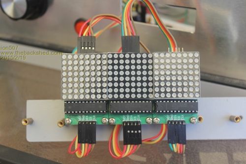

G'day All,
I've been playing around with 3 of these 8x8 LED displays with MAX7219 drivers for the last few weeks as a larger display for my timer project that can be read across the room. I started off with the demo that ViscomJim put on the forum. Since then I have a program that works to display some graphics or a counter but I want to make sure I have the orientation of the displays correct before it is all mounted in a a case as I saw a few people saying that their displays came up sideways or mirrored with some other demo programs.
This is how I have mounted mine:
For this setup, connections from the MicroMite come in at the bottom of the left display module. The output from the first module is then fed to the bottom of the unit on the right and repeated. If I do an SPI write &H0101, the top left LED illuminates.
Have I got my display upside down? &H0101 turns on the LSB of column 0 according to the datasheet.
Is there a convention for feeding the serial data in from the left module or from the right? The software can be modified to suit either but someone must have an idea of how it is usually done.
Thanks for members help with my previous queries, I'm slowly getting up to speed with the MicroMite.
Cheers,
MM_Wombat

I had this version running using my maximite v3.2, with a modification to the source code to turn the spi from an 8 bit to 16 bit routine.
A Link to that thread. Picture and small video...
I'm pretty sure I had the data coming in from the left, and then moving into the next chip on the right, then the next on the right.
