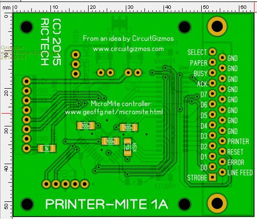

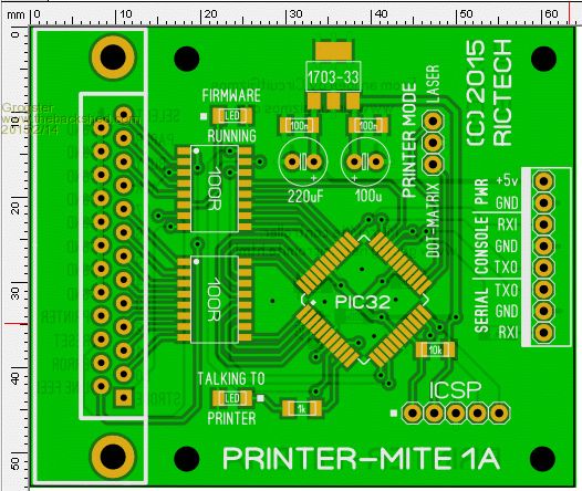

As an expansion on the code we talked about in the forums a while back, on printing to dot-matrix parallel-port printers, here is my latest PCB.
TOP COPPER:
BOTTOM COPPER:
The board will cater for pretty much any standard dot-matrix parallel-port printer, but I also have plans to support parallel-port laser printers as well, in a limited fashion.

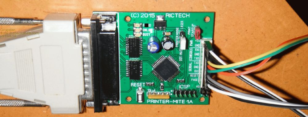

UPDATE: The boards have arrived, and I have got the first one running
There is a small censor block for the uppermost SMD LED - I meant to rename that "D'OH!" for as an error signal, but I kinda forgot to change the silkscreen before I sent the board off for production - whoops....
The current code only supports dot-matrix printers, but works fine, and I am working on the laser side of things - that requires buffering a page in the MM, and then clocking it out to the printer. A supported laser printer with a parallel port is needed to use this side of things.

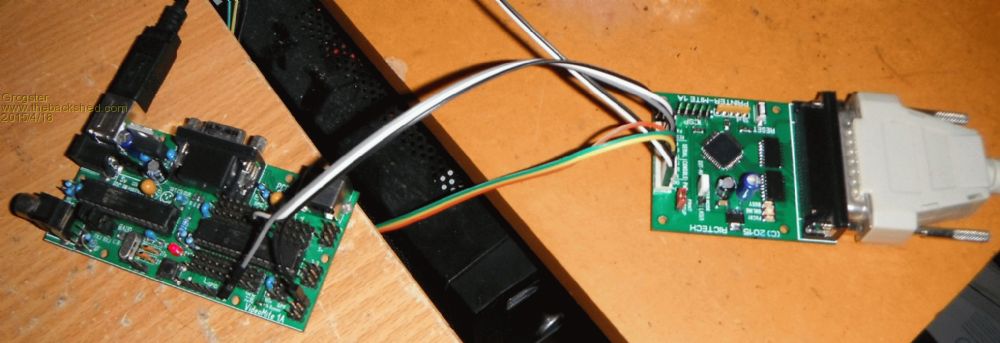

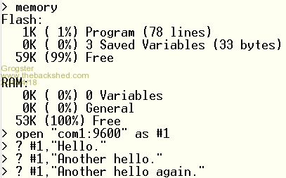

Here is a shot of it hooked to a VideoMite:
In this case, I have the VideoMite's COM1 connected to the PrinterMite's serial input, and you just send it strings and they are printed for you.
The PrinterMite stores message strings in the serial buffer, and can receive more messages while it is printing out the previous one, so long as the RXD buffer does not overflow. Thanks to the 170 MicroMite chip's extra memory, the standard serial buffer is 4096 bytes long, which is enough for up to 51 standard 80-character printer lines before the buffer overflows, and the module is always working to empty the buffer. 10K of RAM is also reserved in an array for the lines on a laser-printer page, but even with this memory gobbled up, there is still 30K or so of free memory.
Any string sent to the module is sucked out of the RXD buffer and passed to the printer, which allows you to send printer-specific control codes for special print modes etc.

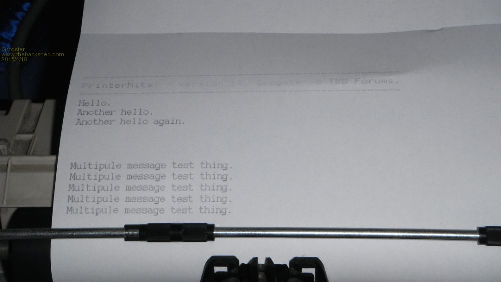

I forgot this evidence photo:
The multipule message test was just the VideoMite sending the same message five times in a for-next, and it was then up to the PrinterMite to decipher the messages and print them out, so this seems to be working at first glance.
