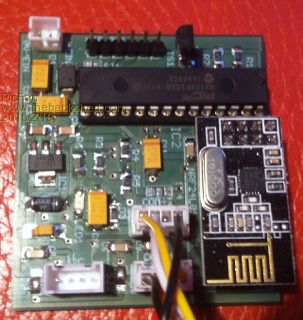

Thank you for your great work! I only have 2 small problems:
I have built a wireless measurement system with 4 transmitters and 1 receiving center (433MHz or 2.4GHz). It works for months with PIC150MX128B without problems, but since I upgraded to PIC170MX256B following problems have occurred.
1.)
If I Change the batteries in the transmitters at 3 times will exchange, minimum 1 times the Basic program is deleted. The pins console TX / RX are not wired, they are open. With and without capacitor connected to pin 1, the problem persists. (During batteries replacement, the CPU is in sleep mode)
2.)
In the receiving center, the COM1 of Micromite 1 is connected to the console of Micromite 2. Upon loss of power supply, loses Micromite 2 almost always the program, Micromite 1 also, but less frequently.
I have replaced the chips, but the same problem.
I think the problem is related to the "option PIN" together, if you forget your code to delete the program.(Console RX Connect to TX and Power on)
Maybe it would be better to delete the program after 3 or 5 incorrect Code entries? (Configurable ?)
Sorry for my bad English !
Thank you and best regards from Austria !
Wolfgang

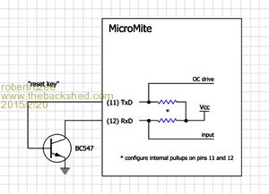

Posts: 2552
Posted: 03:57pm 19 Feb 2015
i've commented on this issue before :-)
personally, i would be happy to see the "short together console TxD and RxD" feature removed completely. it does seem to cause a small but distinct set of users a great deal of trouble, and i feel sorry for these folks.
the present system also precludes creating any micromite based product where the console pins are exposed.
an alternative? if one is indeed needed: how about a 'key' that has to be plugged into the console connection. perhaps an inverter between TxD and RxD pins? this would requite just 1 transistor and maybe a base resistor. configure the internal pullup on RxD as the collector resistor. the onboard current limiting on the TxD pin may be adequate to eliminate the need for a base resistor. if TxD could be configured as an analog input, it would also be possible to measure the transistor's Vbe as an extra level-2 check.
and here's an absolutely foolproof, albeit bizarre solution - require a DS18B20 to be plugged into the console to achieve a reset. connect TxD to the sensor's Vcc pin, RxD to the data pin. one could even require the user to touch their finger to the sensor before performing a reset, to prove they are actually human, and not a robot!
rob :-)

Grounding MCLR will not work as the chip is held in reset and so the firmware looses control and does not know what is going on. Dedicating one pin to this purpose sounds rather wasteful given that most people use the 28-pin Micromite. Timing between resets has technical issues (timing info would have to be repeatedly saved to flash). Inverting the signal could easily cause false resets as the current system does.
I like the idea of connecting a DS18B20 (now that was "thinking outside of the box") but it is complicated and hard to explain. However it would certainly stop inadvertent resets and program wipes.
With the cheap PICKit 3 clones perhaps the best course is to just remove the reset feature and tell people to reload the firmware. If the worse happened to someone who bought a pre-programmed Micromite they would only be $20 out of pocket. Hopefully this would be a rare event and the bonus would be that they could then load future updates.
