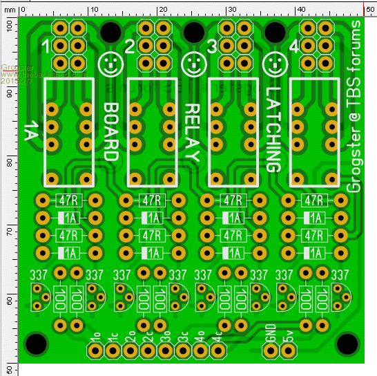

Hi folks.
Here is my latching relay PCB. Lets you control up to four sperate DPDT latching relays on the one board. Full transistor driving on-board, and all relay contacts brought out to pin headers. 50 x 50 PCB size, so nice and small-ish. Each relay can handle up to 2A @ 30v DC per pole.
PLEASE NOTE THAT THIS BOARD IS NOT DESIGNED FOR, NOR SHOULD IT EVER BE USED TO SWITCH MAINS VOLTAGE.
I would hope that members here would know that, but I feel I should point that out, before someone makes the attempt. If you need to switch more then 2A, you can use the latching relay, to switch other more powerful relays - that is actually how I have one of the prototype latching relay circuits setup.

TOP COPPER:

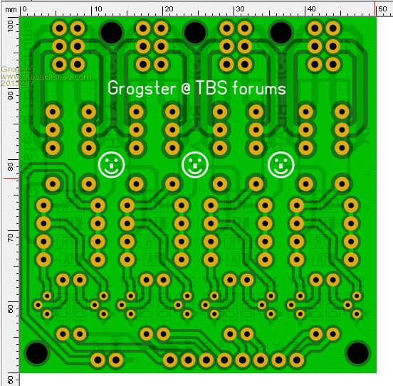

BOTTOM COPPER:

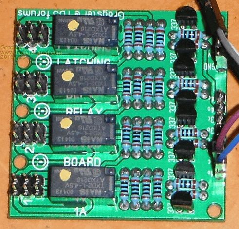

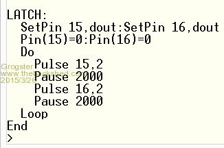

Boards arrived and I finally got a chance to assemble one.
I have been able to get reliable operation down to a 2ms pulse.
Any shorter then this, and the relay fails to latch.
3ms would be a safe figure to ensure correct operation.
Discussions on this thread have convinced me to swap the high-side diodes for plain resistors. Original called for 47-ohm resistors, so I put two 100-ohm resistors in parallel(one where the 47 was, the other where the diode was, which wires them in parallel) to give me a final resistance of 50-ohms or so, which is pretty close to 47.
