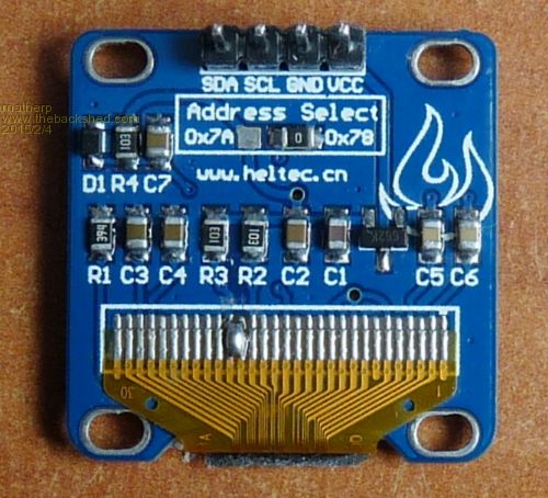

Posts: 12176
Posted: 02:50am 04 Feb 2015
When used for I2C the serial-in and serial-out pins to the display must be tied together, otherwise I2C, where they share a pin, won't work.
The arduino world has produced a hack to allow i2C to work without receiving acks and naks from the slave. This can only be done by bitbanging the I/F.
It is possible that this display isn't correctly set up for i2c in which case you need to mod it. Pins 19 an 20 from the display need to be connected together. I did this on one display which had the problem with a blob of solder. I'm trying to find the reference for the pinout but hopefully the picture will help
I can't think of any other reason why the code wouldn't work if wired correctly.

Posts: 12176
Posted: 03:08am 04 Feb 2015
Sorry - just found the reference. You need to connect BS1 (pin 20 to VCC pin 21) to put it properly into I2C mode as in the picture. Make sure BS1 isn't tied hard to ground without a resistor.

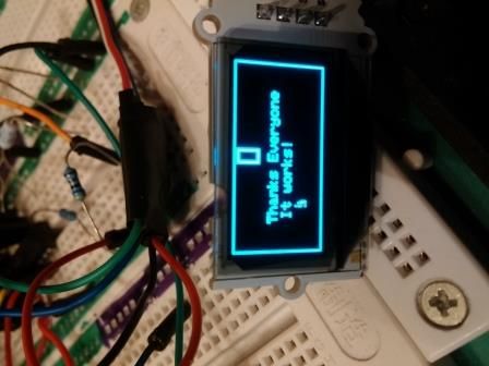

KRZ3
Joined: 31/12/2014
Posts: 39
Posted: 01:56pm 04 Feb 2015
It works! Soldering the two pins together brought it to life.
