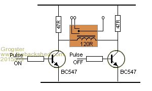

Hi folks.
I have some single-coil latching relays. These are the type where you put the juice on the coil one way, and the relay contacts close. To release, you have to put the juice on the relay coil in reverse polarity.
There are plenty of ideas and circuits very similar to this one I found on the net:
The theory is sound, and nice and simple etc.
My only concern is back-EMF. Normally, in a relay circuit with a driver tranistor, you would put a back-EMF diode across the coil. However, that only works if the juice to the relay is always going to be in the same polarity - you can't do that with a coil where you flip the polarity around.
So, can anyone suggest anything better, or perhaps a way to improve on this circuit I found?
Perhaps I am being over-cautious, but back-EMF is a transistor-killer!

In this circuit wont the two 47 ohm resistor in series (94 ohm) that are effectively in parallel with the coil suppress the back-EMF voltage?

@ disco4now: Yes, I think you are right there. Collapsing magnetic field will be reverse-polarity of supply voltage, and will effectively be shorted out via the two 47R load resistors - I must stop posting questions at 3AM my time - brain is half asleep, but fingers are still working......

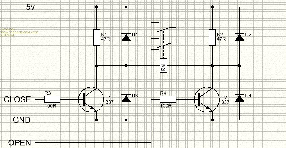

EDIT: How about this revision of the circuit?
All diodes are standard 1A type. I stole this concept from the internal schematic of just about all H-bridge motor driver IC's. Those diodes should clip anything one would think.
Thoughts?
Opinions?
Edited by Grogster 2015-02-05

Posts: 6609
Posted: 03:59pm 04 Feb 2015

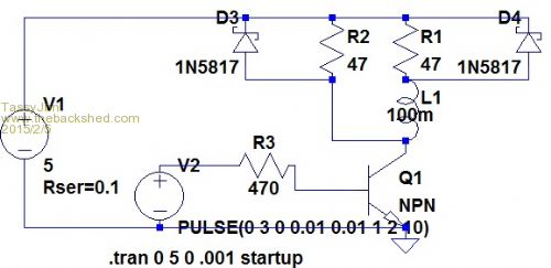

I did a spice simulation with 2 diodes. No idea what the inductance of the coil is so the actual spike size is irrelevant but two diodes (I used schottky diodes) did do the job.
Drawing the circuit this way makes it look like a conventional relay control.
For each direction, one diode is forward biased during the back emf period.
Both diodes are reverse biased during the time the transistor is 'on'
I would still like to do a real life test 'cos I don't trust my simulations that much.
Conclusion - the relays Grogster has should be OK to use.

  disco4now said   In this circuit wont the two 47 ohm resistor in series (94 ohm) that are effectively in parallel with the coil suppress the back-EMF voltage?
Gerry
Yes, that's right.
If the supply voltage is 12 Volt, then the relay current will be 12/(120 + 47) = 72 mA.
When the transistor is turned off, then this current will continue to flow initially & decay exponentially.
The voltage across the 47 Ohm resistors will be 0.072 * 47 = 3.4 Volt. (i.e. 3.4 V across each resistor giving a total Back EMF of 3.4 * 2 = 6.8 V if measured between the 2 collectors)
Thus the collector voltages will be 12 + 3.4 = 15.4 V for one transistor & 12 - 3.4 = 8.6 V for the other.
Therefore neither transistor will be damaged.
