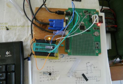

Here is some code and a picture.
The .ASM file is the code to blink a led on pic16f88 pin RB0.
The hexfile.HEX file is the assembled pic 88 code and is currently hard coded but the code can be altered to allow user selection of different HEX files.
The file picprog8.bas is the MM programmer code.
The file "spare code" is leftover routines from conversion from strings to number arrays.
In the MM code, progmode can be "1" or "2". "1" is for say a 628 chip and "2" is for a block programmed pic such as a F88.
The pin connections can be seen from the .BAS code.
Menu item 1 puts the pic in LV programming mode and must be selected first.
Menu item 6 erases the PIC
Menu item 10 loads the hexfile to the arrays and extracts the config word.
Menu item 5 programmes the memory and eeprom and config.
Even if no one uses this, there should be some useful code blocks in it.
This code and programmer are only functional and can be "prettied" up to make it more user friendly.

x Run PicProg8
x 'Setup' option 7 (set parameters)
x 'Setup' option 8 to save data and option 9 to revert to main menu
x 'Menu' option 10 - load HEX file
x Apply power to the PIC
x 'Menu' option 5 will erase and programme the PIC
x 'Menu' option 4 will verify all programme and eeprom.
If you want to set a different config word to that in the HEX file, first set a and save config word of 3FFF
After having selected option 10 (load hex file), go back to the setup, alter the configword and save.
Programme as normally and then reselect setup option 7, change the config word, save and return to main menu.
Select option 1 (lv prog mode) then 9 which will write the new config word. This can be verified in option 8.
the results are shown in binary with address 2007 being config and 2006 being device ID.
Hope that isn't too confusing.
Now to get a simple PICASM8 assembler working.
2015-02-24_111117_picprog8.zip
David M.
