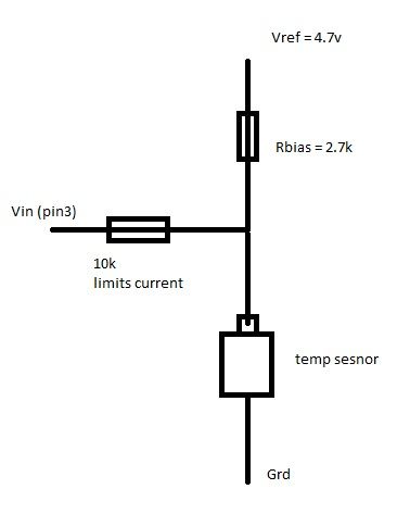

My first sub routine in my quest to create an engine monitoring system.
Most car temperature and air sensors are Negative temperature coefficient. NTC means the thermistor's resistance decreases as the temperature rises.
MicroSquirt has a nice write up on them.
http://www.useasydocs.com/theory/ntc.htm
init_IO()
print "Pin 3:" Pin(3) "V"
tempSensor(3)
print "Temp:" TF "F"
print "Temp:" TC "C"
Sub init_IO()
setpin 3,1
End Sub
SUB tempSensor(PinNbr)
'Negative Temperature Coefficient Thermistors
Local SHa, SHb, SHc, VRef, VIn, Rb, Rs
SHa = 0.001664747834
SHb = 0.000210327648
SHc = 0.00000017870915
VRef = 4.7
Rb = 2673 'Actual measurement of resistor
VIn = Pin(PinNbr)
Rs = Rb*(1/((VRef/VIn)-1)) 'Voltage divider reversed to find temp sensor resistor
TK = 1/(SHa+(SHb*LOG(Rs))+(SHc*(LOG(Rs)^3))) ' Steinhart-Hart equation
TC = TK-273.15 'Celsius
TF = TC*1.8 + 32 'Fahrenheit
End SUB
The analog inputs have a limit of 3.3v max, so every sensor input would need a voltage divider? If I measure the volts with a DMM, they are slightly (20-100mv) off what the Maximiate reads, not sure why yet.

You can work out the maximum possible voltage at the sensor (ignoring open circuit conditions).
Being a cold climate where you live, I would use minus 20 degrees C.
Provided the voltage is less than 3.3V, you don't need a voltage divider.
The 10k input resistor should protect the 'mite if there is an open circuit.
The voltage that the 'mite reports is relative to the supply voltage so if is not exactly 3.3V, there will be an error. You can either adjust the formula to suit the supply voltage or use an external voltage reference and calibrate to that.
Any electronics in a car is going to be subject to some nasty interference so there might be a lot of input protection needed and any protection is likely to interfere with the voltage readings.

The special pin(0) function detailed in the MMBasic manual reads the internal reference
voltage expected to be 1.2 volts.
So (PIN(0)/1.2) should give a compensation if the supply voltage varies from 3.3 volts.
You could try multiplying your read voltage by (PIN(0)/1.2) to see if you get any closer to what you expect.eg.
VIn = Pin(PinNbr) * (PIN(0)/1.2)

I worked out my a,b,c finding 3 references using Thermistor Calculator.
http://www.thinksrs.com/downloads/programs/Therm%20Calc/NTCC alibrator/NTCcalculator.htm
At 3.3 and my bias resistor, the temp will be +2C. Once I figure out the voltage, I can play with the bias resistor to move my limits. I'll dig out an LM7805 5 volt regulator and play with that.
Gerry, I can't find anything about 'special pin(0)' ? Print PIN(0) comes back as 0

pin(0) is an internal 1.2V reference but it is only on Micromite Mk2 with MMBasic 4.6

I hooked an up LM7805 5v reg, still chip input and dmm don't match. 20mv-40mv off. I did learn the power ground and chip ground are isolated from each other
What am I missing here with analog input? I should be able to get values closer in volts. The AREF looks like a dummy pin just for those Arduino shield boards?Edited by MolsonB 2015-02-01
