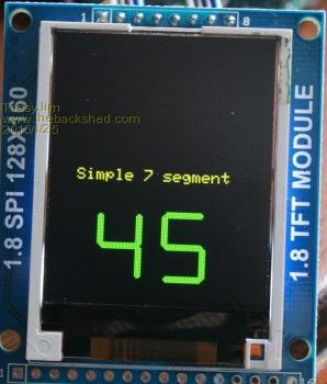

This is a basic way of printing 7 segment style numbers using 'draw filled rectangle' from Peter's TFT code.
It has 3 sizes. This image is size '2'
Each digit takes between 18 and 44 mS to draw, depending on the number of segments.

Decimal points should be easy to add if required.

Posted: 12:55pm 01 Feb 2015
Decimal points and the colon are simply filled circles.
Degree is an unfilled circle.
New numbers will likely over-write the DP so it would have to be re entered after each write.
To keep you going, here is an update that has size zero numbers.
