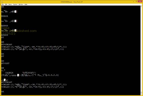

I now have one working but have a strange problem; some characters are not being displayed correctly in Tera Term (TT).
WHILE the log from TT shows :-
AT
OK
AT+RST
OK
ö,"
YâG@ÇR búbc8$ýbº÷
[Vendor:www.ai-thinker.com Version:0.9.2.4]
ready
AT+CWLAP
+CWLAP:(3,"AndroidAP",-38,"78:4b:87:5b:6b:d7",11)
+CWLAP:(3,"BobNet2",-60,"08:bd:43:4b:1b:e5",11)
OK
As you will see still some junk in the log BUT "better" than the screen!
Any thoughts?

I am guessing that you are using auto-detect for setting the baud-rate, by just sending "AT" and <CR>. The module locks onto that, and sets the baud-rate.
I have had very limited success with that method, and plenty of modules support it.
I always prefer to set the baud-rate to a known speed, then you can rule out any kind of auto-baud mishaps which may(or may not) be taking place.
AT+RST sounds like a system reset command, and if that is the case, it is likely that this will reset the default baud rate too.
Ignoring that rubbish text for the moment, is the module OK from that point on, or does it intermittently keep coming up with the rubbish text?
