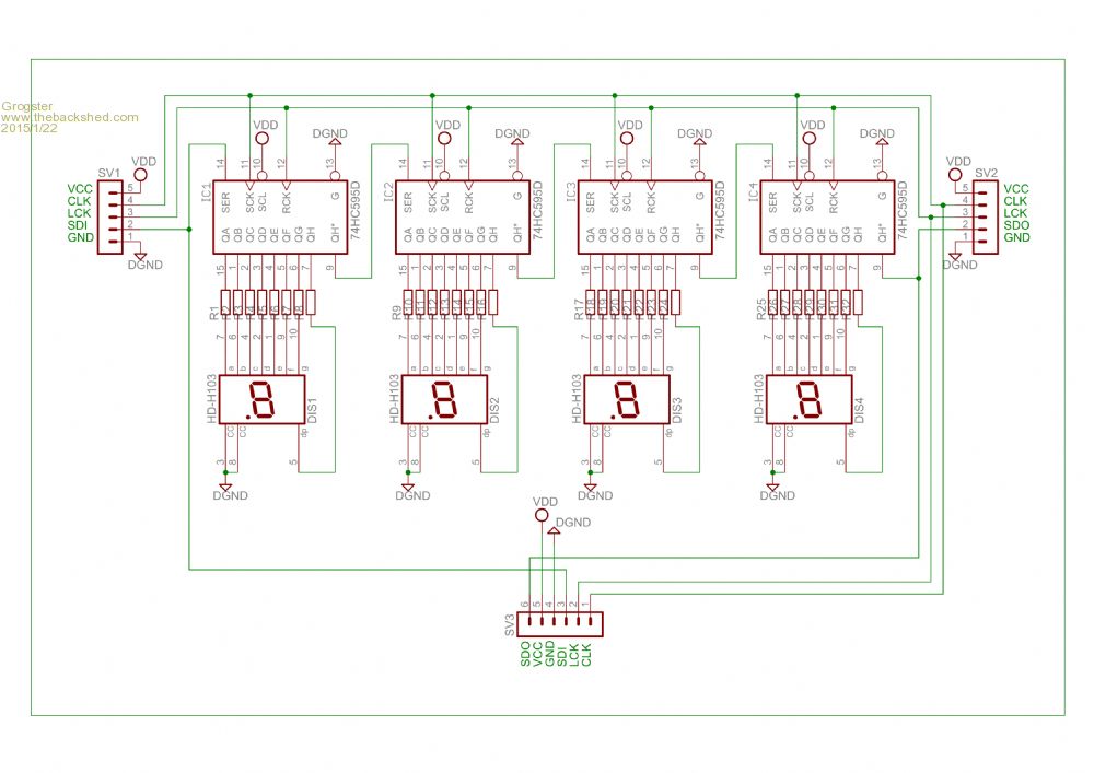

Here is the circuit for the display, stolen from an image on the link above:
From what I can see, all 595's are daisy-chained together(you are right!), so to show any four digits, I need to clock 32 bits to the display, then clock the RCK line, which should pass that data through to the segments, lighting up what is needed.
While clocking the 32-bit data to the display, I get the impression that the display will not change, until you clock the RCK line. Each time you do that, whatever bits are loaded into the registers will be reflected in the output - in this case, LED segments.
Posts: 10048
Posted: 12:20am 22 Jan 2015
  matherp said  If it is 4 chips use SPI OPEN 1000000,3,32 to send all the data in one go
then:
i=spi(&HFFFFFFFF)
pulse LT_latch,0.01
should light all the display elements
Do you have any bright ideas as to how I would build the 32-bit word to send to the display, representing the four digits I need?
Lets start with something simple like "1234"
Assuming the data from the Arduio code is right, then the 8-bit data for the numbers would be: "1"=&H60, "2"=&HDA, "3"=&HF2 and "4"=&H66.
How do I combine those bytes in the correct way, to generate the 32-bit word to send?
Posts: 11908
Posted: 12:21am 22 Jan 2015

Posts: 11908
Posted: 01:51am 22 Jan 2015
  Quote  o you have any bright ideas as to how I would build the 32-bit word to send to the display, representing the four digits I need?
dim integer a=&H12
dim integer b=&H34
dim integer c=&H56
dim integer d=&H78
dim integer s=(a<<24)+(b<<16)+(c<<8)+d
