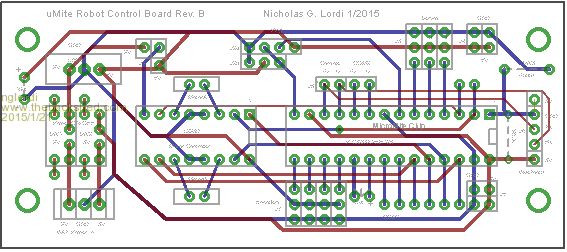

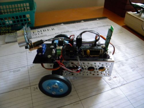

The attached figure (robot.jpg) shows my micromite controlled robot. It consists of an Actobotics platform with a with a control board (umiterc.gif) designed to interface the micromite with a L293D motor controller. The board allows easy connection of up to 3 servos, a ping, bluetooth module and an IR remote sensor (not shown). Two Li-Ion rechargeable batteries power the board. A 3V battery powers the micromite and the bluetooth module. A 9V bsattery regulated to 5V powers all other components. One can select either 5V or 9V to power the motors.

I would appreciate any comments, suggestions, etc.
