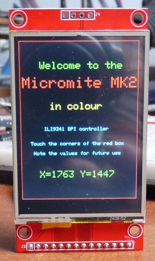

ILI9341calibratetouch.bas uses the graphics routines and the touch routines and displays the coordinates wherever the screen is touched. This allows you to note down the maximum and minimum coordinates of the display screen for use in calibrating touch applications. In my case the x coordinates run backwards.

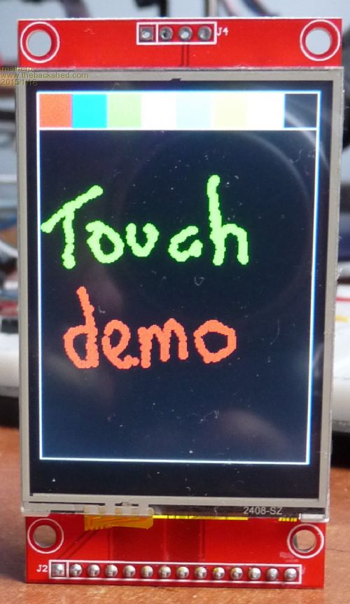

ILI9341touchdemo.bas is a demo painting program using the touch input and graphics routines. Touching just below the drawing area on the left side clears the screen. Touching one of the colour blocks at the top of the screen changes drawing colour. The coordinates from the calibrate routine are used to define the xmin, xmax, ymin and ymax parameters. The software scales the touch position to the screen coordinates to draw the trace including reversing the sense of the raw x-coordinate.

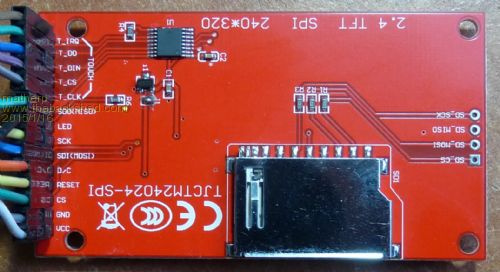

The third picture shows the bottom of the PCB. There is a shorting link just below the small three pin voltage regulator. For 3.3V usage with our Micromites this link should be made to bypass the regulator.

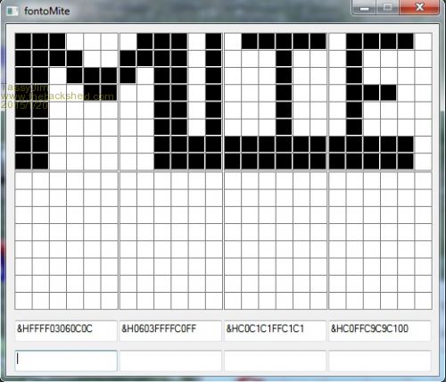

Posted: 07:23pm 17 Jan 2015
All you need now is "font-o-Mite"
A simple utility for creating those missing characters.
Nothing to install, just download and unzip.
Click on the pixels to toggle them on or off.
The HEX characters are in the lower box ready to copy and paste.
You can also paste HEX characters (with or without the leading "&H")
2015-01-18_052153_fontoMite.zip
Something to play with while I wait for the display modules to arrive.

Posted: 10:34am 18 Jan 2015
Glad you like it.
My next task is to take the font data as presented in Peter's cfunctions and swap the order so they display correctly without having to do a manual swap.
That will make modifying characters easier.
I was also considering making it a 4 x 2 display of characters so you can create characters that flow across character boundaries.

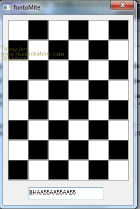

Posted: 09:05pm 19 Jan 2015
The new improved version.
You can create 8 characters at once. Useful for high-res characters.
Single click on a pixel to toggle the colour.
Double click to invert all pixels for that character.
Clear the text area to clear the character.
You can cut and paste a number from Peter's font cfunction and font-o-mite will recognise the format. This makes starting with a preformed character easier.
Right click to swap the HEX value from normal hex numbers to the layout used in cfunctions. Useful if you want to paste the altered character back into the font cfunction array.
2015-01-20_065811_fontoMite.zip
