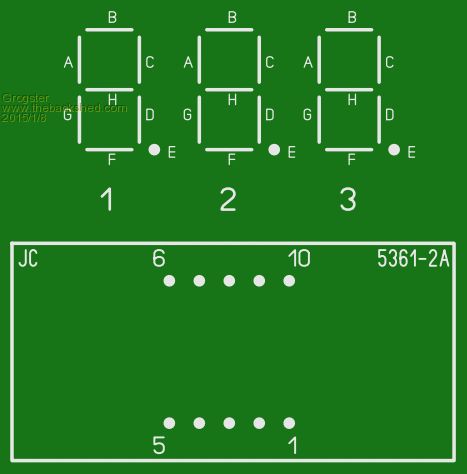

Hi folks.
I have 20x 3-digit LED displays here that I would love to use for a project.
Problem is, there is no datasheet for them, and I have not been able to get anywhere with my usual friend - Google.
The only ID is inside the epoxy which reads: 5361-2A on the top-right of the display, looking at it from the rear. At the top-left, there is: JC, and pin-1 of the display is marked.(it is bottom-right of pins).
The display has ten pins - 5 on the top, five on the bottom.
It is obviously a multiplexed display, but I don't know if it is common-anode or common-cathode, and I have no idea which common is which pin, nor what pin is which segment.
Does anyone know of any places I could look to perhaps find some data on these?
I am also thinking of putting a MicroMite to work here, and connecting all ten pins to the Micromite(with loading resistors!), then by running some code where it steps through all the combinations one by one high then low with a button press, I can then write down on paper as the Micromite steps through, which pins result in which segments lighting. From that, I could decipher the pin arrangement, but someone else might have a better link or source?
...it could be an interesting use for a Micromite though!

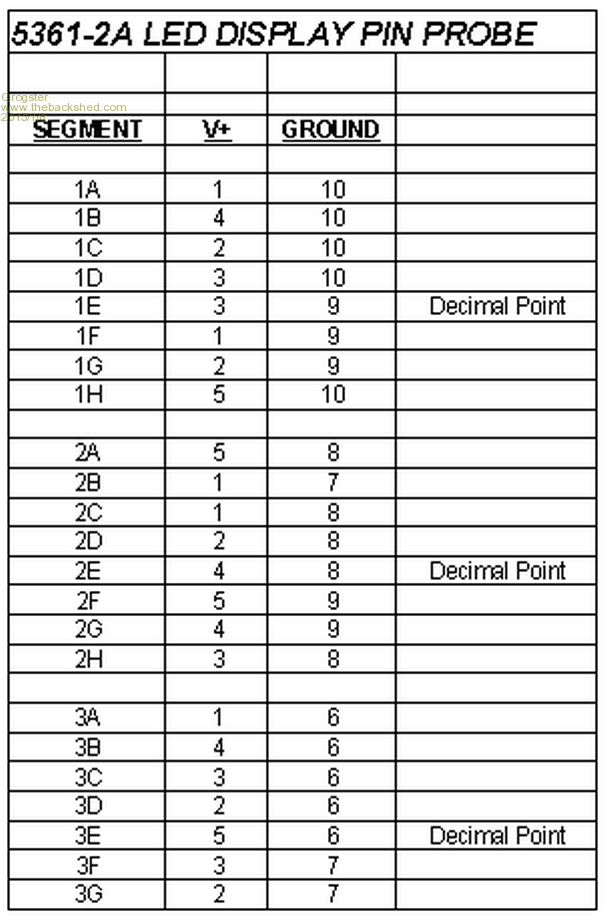

Just get a 1k resistor and 12v (or so) power supply, or battery. Make the resistor in series with one power lead. then just go around and touch any 2 pins until a LED lights. Leave one of the power leads connected and move the other one to other pins til you get a different LED to light.
Just keep that up until you have gone around all pins, You will get a couple of connections where no LED lights, use this no led pin to move the first connection to and redo all the other pins again.
A bit tedious but pretty easy when you get the general idea.
Being a 3 digit display will give you 3 pins that light no leds. these 3 are the commons, either A or K depending on the display and the polarity of the wires connections.

Here is what I have found so far:
Display graphic:
Pin probing chart:
From what I can gather, is is therefore a common-cathode display, but interestingly, there seems to be five distinct groups of common connections instead of the more usual three(one for each digit).
Can anyone here make more sense of this chart then me at this point?
EDIT: I am now going to draw this chart as a schematic to see how things are set up behind the epoxy.
EDIT: Last line is missing from the chart. Segment 3H: V+=4, GND=7.Edited by Grogster 2015-01-09

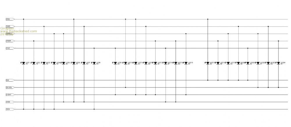

Here is the schematic, drawn from my probing chart:
Me thinks this is a matrix LED display rather then a common-cathode.
The same thing as a keypad matrix, but just a little little larger.
No wonder I got them for about 50c each at the time!
Still, now that I know how it is wired up, I could easily dedicate a $3 MicroMite chip to act as an I2C or serial driver....
EDIT: Image is a little fuzzy, so here is a link to the GIF file which will show it clearly.Edited by Grogster 2015-01-09

looks like there are 24 segments, arranged in a 5x5 grid. the only combination not used is 5-7.
working out how to drive it will be fun, but not too difficult. hint: for each digit (0-9) in each location (1-3) you'll need to store 25-bits, which will all nicely fit in a table of 30 integers on a mk2 micromite.
rob :-)
