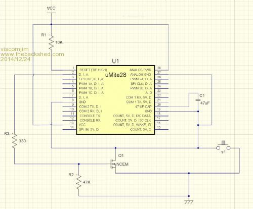

On this same approach of using a mosfet to power the circuit once a switch is pushed to "start" the circuit and then the uMite turns itself off basically, has anyone had any good experiences with the "logic level" fets that work on 3.3v instead of the 5v. There doesn't seem to be many options when it comes to a 3.3v logic level fet that I can find anyway.
Any ideas or experiences?
EDIT...
This is what I'm thinking... The switch get pressed and the uMite gets powered on at which time the uMite turns on the mosfet and keeps it on until it is done doing it's thing and then turns it off. I am switching the ground, and am not sure if this is ok. The second thing is that the mosfet needs to be able to switch about 1 amp max which is why I am not using just a little transistor. The rest of the circuit is not shown, but there will be just a bit of current draw when the mosfet is on.
The mosfet right now is the irfz44n or this one.
EDIT2...
I guess I could also switch the high side also using a small relay quite easily, but solid state is cooler... I haven't found any p channel mosfets that work with 3.3v.Edited by viscomjim 2014-12-25

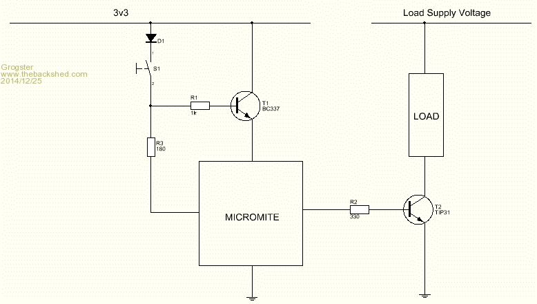

I still don't understand your use of the MOSFET as your uM switch, vs the predicted load of 1A.
For switching on the uM(if using sleep and a 80uA or so sleeping current is not acceptable and you want ZERO off current), you could just use the transistor you mentioned - that would be how I would do it, if I was doing what you are doing.
Transistor to keep the uM awake once the button was pressed, then the uM can switch the transistor off when it was finished and power itself down as you are already suggesting be done.
I would then move the MOSFET to another I/O pin on the uM, and have the code switch that, to use the MOSFET to switch your higher current - there appears to be plenty of spare pins...
EDIT: This is how I would be inclined to do things:
Using a couple of cheap NPN transistors. You COULD use MOSFET's, if you could find some 3v3 ones. I'm afraid that MOSFET's are not really my field - I was trained in the bi-polar transistor era!
Anyway, using an NPN signal transistor as an emitter-follower to power the uM - that works fine for the low current the uM sucks when running, and although there is a voltage drop across the transistor, it is still within the power supply voltage requirements of the PIC32 chip.
The TIP31 output switching transistor is wired as a common-emitter with the load in the collector circuit.
There should be ZERO current consumption, until you actually press the switch. When you do, this powers up the uM, and one of the first things it does, is set an I/O pin high to hold T1 on, and this keeps the power on to the uM when the switch has been released. The 180 ohm resistor protects the uM from current, and D1 prevents the uM from sending voltage back onto the supply line once the button is released.
All that is just a quick drawing, and not tested at all, but it should work. I could build it later to test this idea if you like.

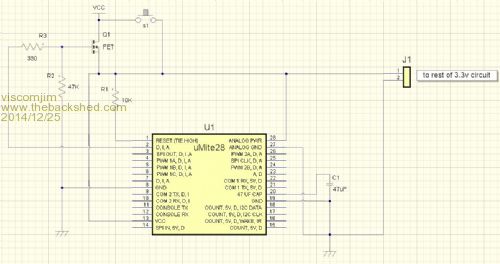

I like your idea and will go over it my head for a bit. The "load" is also using the 3.3v supply but I think your circuit will still do the trick. If you have the parts available, a test would be very much appreciated if time permits. Could T1 be something like a 2n2222 type of transistor?
Thanks for your time on this!
EDIT...
Since the rest of what is on this circuit is also 3.3v operation, maybe this could work...
Edited by viscomjim 2014-12-26
Posted: 05:41pm 24 Dec 2014
The base of T1 has to be 0.6V (approx) above the emitter for it to turn on. Not easy to do when you are supplying the base via the emitter.
I would use a PNP transistor and using an open collector output from the uM to hold it on.
In my case, I want to switch the regulators as well so I will be going with an opto-isolator. Easier to level-shift and I need them anyway for isolation.

@ viscomjim - I don't know the specs of that transistor. Generally speaking, more gain is a good thing with trasistors.
Something important to remember about transistors: they are NOT switches, they are current amplifiers - IE: The current flowing in the collector-emitter circuit is proportional to the current flowing in the base-emitter circuit(for NPN).
It is VERY common for people to confuse a transistor with a switch.
If your load runs from 3v3 too, then you might have to go back to MOSFET output driver instead of the NPN TIP31 transistor, as the voltage drop across the transistor could prove a problem with a 3v3 supply and some reasonable current.
Is your 3v3 load on all the time, or is it switched on and off with the uM?
  TassyJim said
Absoueltely right - well spotted. I was on my way out the door to my brother's place for family Christmas dinner, and so the drawing was right from my head, and not tested at all. I also agree with the PNP idea.Edited by Grogster 2014-12-26

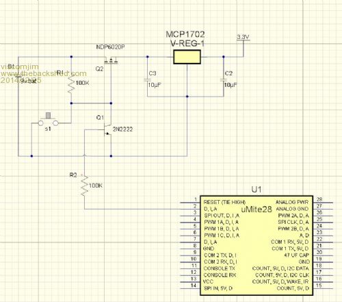

Posted: 06:50am 25 Dec 2014
After doing a bit of research, I think I found a decent way to do this using 2 resistors, a P channel fet and a common npn transistor. Thoughts???

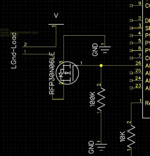

jman
Joined: 12/06/2011
Posts: 711
Posted: 12:12pm 25 Dec 2014
Hi
I have used the RFP30N06LE and the BUK9575-110a Logic level Fets
with great success
both these devices have a max gate threshold voltage of 2volts
so no worries with 3.3v to turn them fully on.
