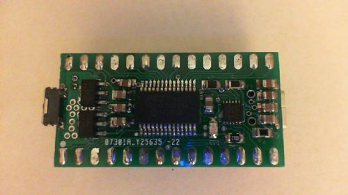

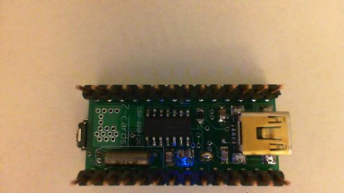

Zonker
Joined: 18/08/2012
Posts: 772
Posted: 05:41am 25 Dec 2014
Merry Christmas Jim...!
Just got done programming 11 of these last night... Lou did an awesome job soldering up the rest of the batch of 21 prototypes... It's a bit pricey at $30 but we got the parts from Digikey so that should be about the "high" price... I am sure they could be built for cheaper... We will probably be sending a few to Phil to have a look at... I guess I could sell a few for the moment....
I will be putting in a simple test program that tests the RTC and Fram chip for the user... I went in to the FTDI chip and reprogramed the tables to allow 200ma of Vbus power so you can power your whole setup from the board... Also made the little blue LED flash during Rx-Tx transfers.... Fram chip is the FM1256-G
2014-12-25_154040_DIP-600-28_DigiKey_BOM.zip
Edit: Fram "chip shot"...
Edited by Zonker 2014-12-26
