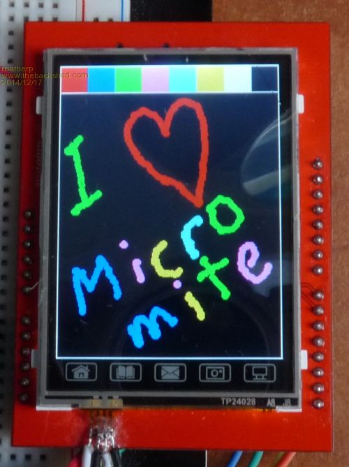

OK so I'm not an artist
This was a bit of a struggle getting to work as I came across a firmware bug in 4.6b26 relating to analogue input modifying the status of other pins. This has been reported to Geoff.
The 2.4" TFT Arduino shield puts the touch input connections onto some of the same pins as are needed for the display. As part of debugging the problem above I disconnected these from the shared pins and connected them directly to the Micromite - you can see the soldered-on connections in the picture.
To understand how to drive directly a resistive touchscreen see the excellent note from NXP
I've also converted an additional routine (fcirch) into a cFunction to speed up filled-circle drawing which I use for drawing the trace.
The code currently polls for a touch but it is easy to set up an interrupt which is triggered by a touch - the statement to do this is identified with a comment in the code.
The Basic code that does the work is pretty simple:

Complete code and updated cFunctions attached:

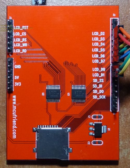

Posts: 12176
Posted: 05:54am 18 Dec 2014
The bottom of the display should be silkscreened as above
connect:
LCD__CS to Micromite Pin 4
LCD__CD to Micromite Pin 5
LCD__WR to Micromite Pin 6
LCD__RD to Micromite Pin 7
LCD__RST to Micromite Pin 14
LCD__D0 to Micromite Pin 17
LCD__D1 to Micromite Pin 18
LCD__D2 to Micromite Pin 21
LCD__D3 to Micromite Pin 22
LCD__D4 to Micromite Pin 23
LCD__D5 to Micromite Pin 24
LCD__D6 to Micromite Pin 25
LCD__D7 to Micromite Pin 26
You also need to connect 5V, 3V3 and GND
The touchscreen code I listed won't work as I have butchered my display to break out the touchscreen pins from the shared pins on the normal board.
Use this code to get you going:

My display arrived today, it looks identical to your picture above except it has a very small resistor network near the top, center.
Your wiring list states:
But there is no LCD_CD pin labelled. The only LCD_PIN not used in the list above is LCD_RS is this the pin that connects to pin(5)?
If so my display doesnt work with your sample code..
It changes the display to be every second row off (from every row on at power up). The code reports Controller type 0000
My controller chip (as stated by the seller) is supposed to be spfd5408 controller with built in video RAM buffer
Any ideas?

Posts: 12176
Posted: 11:15pm 28 Dec 2014
LCD_RS is the pin to connect to the micromite's LCD_CD input (basically selects between register select and data mode). Sorry the naming in the program didn't get edited from a different display.
Lets try and get the display running first and then tackle the touchscreen.
