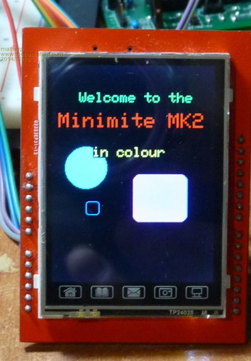

Not fully worked yet but already much faster than Arduino.

Holy Crap! That's exciting!!!! and faster than arduino, even better yet!

Which display is that? I assume touch screen too.

Don't know where I got "Minimite" from duh...
This is the
Display :

OK this code is about ready, hopefully it follows G8JCF's library standards but I await feedback
First some information:
This code has been tested on a display with the ST7783 controller chip. This seems to be the controller used for the 2.4" displays. I haven't got a 2.8" or 3.2" display but I suspect these use a slightly different controller variant. The basics for driving all these displays is the same, however, there may be slightly different sets of "magic" numbers needed to initialise them. The easiest way to find the magic numbers is to find working code from another source and duplicate the initialisation routine.
The displays use a 13-pin interface, 5 control lines and an 8-bit parallel data bus. The screens have 240 x 320 pixels, each of which can be updated with a 16 bit number to set the colour. The format of the number is &Brrrrrggggggbbbbb, i.e. 5bits for the red intensity, 6 for green and 5 for blue. This is known as RGB565.
So, to write the complete display we need to send 260*320*2 bytes of information which is something over 153,000 bytes!
In order to do this in a reasonable time the write software needs to be highly optimised. The attached code can write the complete screen in just 42msecs.
HOWEVER, this means there are constraints on which pins can be used. It is essential that the 8 bit parallel data bus is connected to contiguous pins based on the organisation of the PIC itself and not the pin numbering. Unfortunately using the 28-pin PICMX170 this means that the connection to the display must use the pins for both the i2c connections and the comm1 connections - there is no way round this. The attached code is hardwired to use pins 17,18,21,22,23,24,25 and 26 for the data bus (RB8-RB15 on the PIC). It is also hardwired to use 4,5,6 and 7 for the 4 main control pins. These could be changed in the cFunctions with only a minor impact on performace. Pin 14 is used as a reset line to the display from Basic and can be changed easily.
On a 44-pin Micromite, the problem is much eased. We can use the RC0-RC7 PIC pins for the data bus. These do not conflict with any of the critical Micromite I/O functions. I haven't got a 44-pin chip at the moment but will post revised cFunctions for this when I get one.
These limitations are no different to those on the Arduino where the display plugs into the Arduino and the pins used are completely pre-determined.
Other than the limitation on the pins, the code works well. It uses the same drawing primitives as my other graphics routines except these are now enhanced with a "colour" parameter. Character drawing needs two colours, one for the character itself and one for the background.
I haven't yet played with the touchscreen capability of the display. The lines to the touchscreen share pins with the display itself so you can either be checking for a "touch" or writing to the display but not both at the same time.
Anyway - enough waffle, the code contains the usual complete test harness to check all the functions and demonstrate usage.

Peter
This is just so impressive ! Your productivity is incredible
I really do like the way you've named the variables. One little trick is that MMBasic allows '.', ie period, to be used as part of variable names (David Hall showed us that trick !), and what that means is that one can get an almost object oriented feel/style, eg TFT.Init, Dim TFT.Params(3) etc. to MMBasic code.
The other thing is that when DIM is used, even inside a SUB/FUNCTION, DIM always declares a Global variable, so
dim integer AddrOfFont, TFT_params(3)
AddrOfFont=PEEK(CFunAddr FONT)
should be moved inside SUB TFT_Init().
The Global Constants unfortunately have to remain outside TFT_Init because if one declares Constants INSIDE a SUB/FUNCTION they only have scope within that Sub/Function. For that reason, I tend to not use the Const construct in Libraries, but use DIM instead - practically in terms of storage and performance, it seems to make no difference - eg DIM Integer TFT.Black=&H0000. Then these constants can be declared inside TFT_Init. The whole idea being to make the Library as self-contained as possible.
I think TFT is a bit too generic, so I would change TFT_ to 7753_ so that it is very clear which chipset this library deals with, then we'd have libraries for 7753, 3110, 5110 all written by yourself, and all with the same set of primitives - ah, which of course militates for NOT having chip specific naming, (allowing end users to simply swap in a library without having to change their MMBasic code) hmm ..... Perhaps all your display libraries should have a common naming convention, eg TFT.
I haven't got one of these displays so I can't try out your code sadly
I'm nearly done with editing your 3110 library (I do have one of those displays so I can make sure that whatever I do doesn't break your library).
I hope that my comments are helpful and constructive, and once again, your output rate is just fantastic (you are getting some sleep aren't you ), and you are pushing the boundaries of uMite forward single-handedly.

Modded as per your suggestions. I've used TFT.xxx for the function names and TFT_xxx for the variable names. As far as I'm concerned this is now ready for the library. Do we know where/what it is yet and how to get things in?
