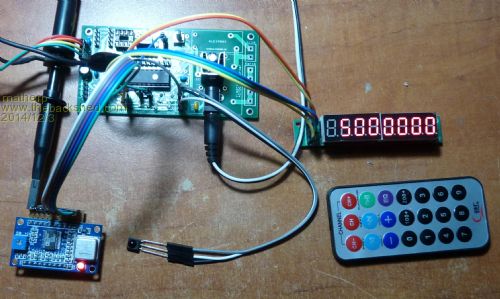

This program is a complete solution for an IR controlled Frequency generator based on one of the AD9850 modules that are widely available.
This will be the last new topic for a bit I promise. The Micromite 2 really does make things very easy. This was going to be a port of the PICAXE program I use for my bench frequency generator but it ended up much easier to start from scratch.
I've put together the code from the NEC IR receiver together with the driver for the MAX7219 display and added a driver for the AD9850 plus a tiny bit of program logic.
The wiring of the AD9850 module is important to set it into serial mode:
VCC pins 1,18,19,20
GND pins 6,11,17
For my program I'm using pins for the AD9850 as follows:
MM2 pin 16 to pin 4 (Data)
MM2 pin 9 to pin 3 (Latch)
MM2 pin 26 to pin 2 (Clock)
output to scope pin 10
I'm bit banging the output to the AD9850 as neither the MAX7219 or AD9850 have a proper chip select. Both just use a short latch pulse to load the data and it seemed wrong to send both all the clock and data pulses and hope they discard the correct ones.
The main program implements a very simple state machine. On startup, having restored the last used frequency (or 1000hz if first time run) it passes through an update mode which updates the AD9850 and then sits in wait-input mode waiting for a character from the IR remote.
On first valid input (0-9) it goes into program-mode and displays the input with leading "." characters.
If a complete frequency is not input within a specified timeout (set to 30secs). The program leaves program-mode and returns to wait-input mode restoring the display to the original frequency.
As characters are input the display is shifted left so the frequency is input most significant digit first.
If 8 digits are input or the "play" key is pressed on the remote the program enters prepare-update mode.
Here the frequency is tested against a maximum allowed (I've set this at 20MHz). If it passes the test the new frequency is copied to the output frequency parameter and the program jumps to update mode as described above.
If the test is not passed the display is restored and the program re-enters wait-input mode.
The frequency calculation has been tested against the Analog Devices online calculator and the frequency output checked on my scope.
By building on the modules posted earlier this post has now taken longer to write than the program.

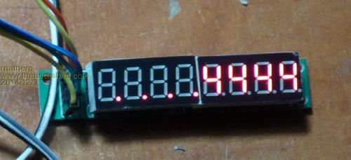

Wait Input mode
Program mode
