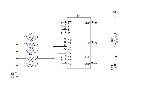

I need a quick answer on this as I'm about to order some parts.
I am working on a very small slim lined package where the number of components is critical.
I will be using these as the 8 sensors http://littlebirdelectronics.com.au/products/force-sensing-r esistor-0-2-circle
Normally when one is feeding an A/D signal to a microcontroller you would create a resistor voltage divider with one end connected to ground and the other to Vcc, and then measure the value between the two resistors.
So in the above case I will also have to fit an extra 8 resistors onto the system.. Unless...
I tie all of one side of the sensors (r1 - r5) to ground, and the other side in to the inputs of the 4051. The A/D output of the 4051 will have the 10k (r6) to Vcc, so that each time I read a sensor it is effectively in a voltage divider configuration.
Or have I gone completely off track.
Many thanks
Marcwolf

Your circuit above should work OK.
The resistance of the sensors is well above any on resistance of the 4051 so that will not be a problem.
The sensors seem to have a fast response time so switching them on in turn should be OK.
Disclaimer: I have only had a brief read of the data sheets.

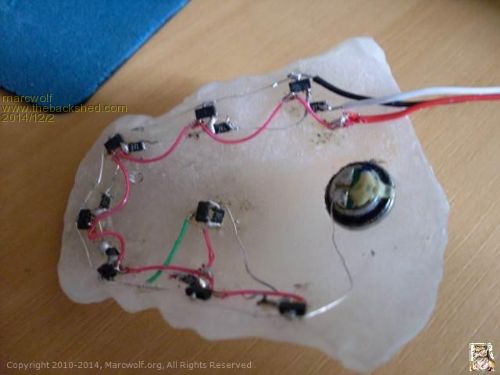

Unfortunately this circuit really has to be tiny and I am playing with SMD components and hand soldering. Below is a previous experiment working on the same solution
I did try using one of these
http://www.gravitech.us/i2c128anco.html
But then ran into the issue of needing a resistor for each sensor to complete the resistor network.
In practice only one sensor will be active at a time.
Again thanks for your quick reply..
