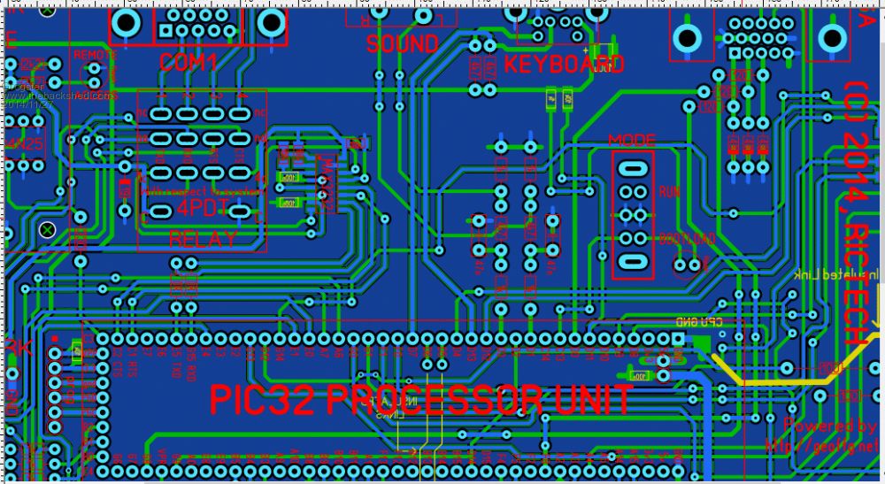

Oh, it IS on a PCB!!!
This is what dismays me as to why it won't work for me.

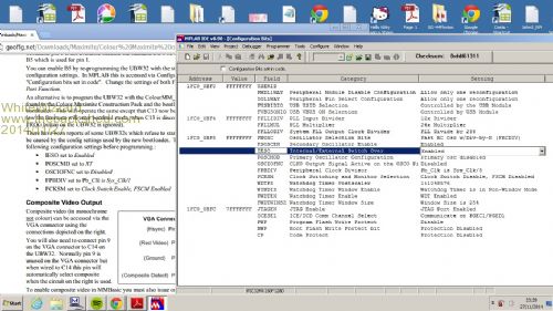

If you use MPLabv 8.90: select 'Configure' tab, then 'Configuration Bits . . .'. You will then come to a screen where there is a tick box for: 'Configuration Bits set in code'. If it is ticked, then unstick it and change the options there. It will become clear if you try it. See screenshot below - this shows you my screen with Page 6 in the background so you can see what needs changing.
Hope this helps you . . . .
WW
ok - small screenshot but hope this guides you enough . . . .
Edited by WhiteWizzard 2014-11-28

Screenshot here for better view: 2014-11-27_234434_GrogsConfigBits_copy.zip
WW

@ WW - Thanks for your post and picture - I have downloaded the nice big clear image in the zip - thanks. I have MPLAB X. I had a look in there, but could not find anything useful to change. Now I have a version and program type to look for, I will see if I can find and download MPlabv 8.9. Can anyone use this software, or is that one of the ones you have to pay a license for?

OK, software installed, and loaded. Selected PIC32 device, connected to PICkit 3.
Changed config bits in the menu as shown by WW, and then closed that window. MPIDE 8.92 still running though.
How do you commit those changes to the PICkit3, or does MPIDE do that as soon as you change them?
I have re-ticked "Configuration bits set in code" - had to untick to make changes.

OK, back home now, and so what I tried next was:
- Open IDE and select correct device.
- Untick set configuration in code checkbox
- Make changes as listed in PDF
- Recheck box
- Close window
- Close IDE
- Open IPE
- Load and program HEX
Still nothing.
What am I doing wrong?
The fact that the PIC32 programs fine every time, SHOULD mean that everything will work as soon as you cycle power. Helpfully, the extra SMD LED's on the UBW32 are useful for debugging purposes, and no matter what I do, or what HEX I program, the only LED that stays on is the blue PWR one. The yellow and red ones don't ever light up. I am watching for the yellow one, as that should indicate that MMBASIC is running, according to the PDF.
EDIT: Does it matter that several external circuits are connected by default during programming? I would not have thought so, but I am clutching at straws now. Perhaps I should remove the UBW32 from the mainboard, and just hook up the programmer and power, and nothing else, then see if I can get it going?
EDIT: No, no joy. I removed the UBW32 module from the mainboard, sat it to one side on the bench, and hooked up just the power and the programmer. Programmed the HEX into it, still dead as a dodo. ...other then that blue LED, that is. Therefore, it is not any of my mainboard circuitry somehow upsetting the programming procedure, so at least we know that.
EDIT: Just reloaded the IDE, and all the config bits are back to the defaults, which is NOT what the PDF lists.
QUESTION: Once you have set the configuration bits in the IDE, how do you ensure that this is applied to the chip when you program in the HEX file with IPE?Edited by Grogster 2014-11-29

Don't re-tick the box otherwise the code overrides your changes.

Why are you not loading the file from the IDE? Otherwise the settings will/could be different when you switch to the IPE
