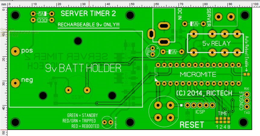

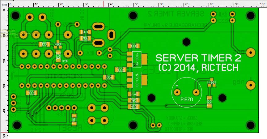

So, I decided to come up with a Micromite powered alternative:
TOP LAYER:
BOTTOM LAYER:
This board is already produced, so there is no design-by-committee issues with this one!!!!!

The concept is pretty simple. The unit trickle-charges the 9v rechargeable NiCd battery, which takes over powering the circuit(via a diode gate) if the juice fails. Please, no comments about the most basic of basic charging methods - it works, and works well. Although constant trickle-charging like this will technical kill the battery quicker then a delta-V monitored arrangement, it will take several years. It is important to note at this point, that I am using NiCd rechargeable battery, NOT a NiMH or Li-ION type - they do need a more advanced charging system.
The Micromite monitors the incoming 12v power by way of a potential divider formed around a 10k and 3k3 resistor. The unit is powered normally by an external 12v plug-pack plugged into the NON-UPS side of the power. When the power fails, so will this 12v supply, which the Micromite will detect. This starts the timer, and once the set time has elapsed, the unit will close the relay contacts and shutdown the server.
The relay contacts are N.O, and are connected in parallel with the system's main power button, simulating a power button press when the timer runs out. The timer has to be set in proportion to the size and backup capability of the UPS being used, such that the timer will time-out BEFORE the UPS goes flat.
In my case, I am using several NASLite-2 x64 servers which run from 64MB(yes - MB, not GB) USB flash drives, and although Linux based, they are NOT GUI based systems, rather HTTP-based, so you cannot install extra software as such. So I needed a way to be able to shut these down in the event of a power cut, but the UPS's I used only had Windoze software to do that.
If anyone is interested in a PCB, flick me a PM.

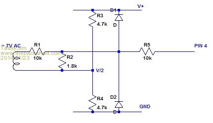

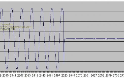

Many years ago (everything seems to have happened many years ago), I worked in the power industry and we have some wonderful old instruments. One I liked was a disturbance recorder. Whenever it was triggered, it would spit out a couple of metres of paper with a chart of the voltages and currents for a few seconds before the event and a few seconds after.
Last week I was sitting at the 'puta when there was a power 'disturbance'. I missed the pretty charts so micromite to the rescue.
The idea is to have one micromite continually reading the voltage and when triggered, spit the 5000 readings out to be analyzed.
A MX150 micromite can take 30 readings per 50Hz cycle and a maximum of 5000 readings.
That gives around 3 seconds.
If you trigger it 2 seconds after the 'event', you will end up with 1 second of pre-event and 2 seconds of post-event.
A MX170 can read a bit faster and store more samples.
I will end up triggering from a second micromite similar to Grogster's setup.
If you aren't interested in looking at the AC waveform, use a rectifier and a small filter capacitor then slow the reading rate down.
For the AC input I found an old plug-pack with AC out.
The chart is a portion of a test drawn in Excel.

There is no time for the micromite to do any calculations during capture but I am impressed with the quality of the waveform in Excel.
Now I have to wait for a real life 'disturbance' to capture.
