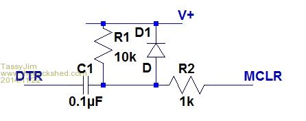

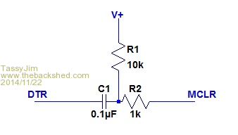

I always put a 0.1uF in series between DTR and MCLR just to make sure that the 10K to VCC on the PIC doesn't damage the DTR output from the USB<->Serial converter

I intend add a resistor in series with the reset line to protect against the high voltage swing when the DTR line goes high again.
The values chosen seem about right but I will have to check...

I have added a diode to clamp the positive swings.
With the pickit3 connected directly to the MCLR pin, programming is not affected with the extra components in circuit. I did however, disconnect the DTR line during programming.
